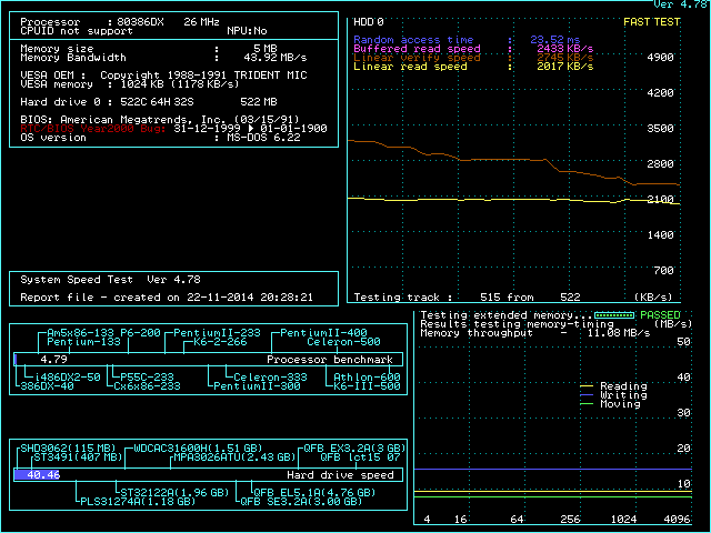

The legendary T-Bird: http://www.classiccomputer.de/pc/asitbird1.jpg
AMD 386SX 25MHz, 1MB(onboard)+4x1MB(SIMM) RAM, Trident TVGA 8900
pimped with an Adaptec 1542CP and IBM DSAS-3540

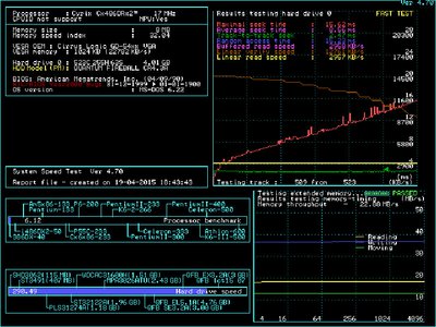

Cyrix 486 DRx2 25/50, 1Kb L1 - 50Mhz
Intel 16-33Mhz 387DX @ 25Mhz
OPTI 25Mhz Chipset, No Cache, Unknown Mainboard with 8xSIPP Slot
8Mb SIPP Ram
4Gb Harddisk, Mitsumi FX-002? CD-Rom Drive 2x with Controllercard
Soundblaster 32 with 2Mb RAM
Ne2000 Networkcard.
3,5", 5,25" Floppy Drives.

Hmm, the performance is actually quite good for 25MHz. Care to tell us which OPTi chipset you have?
Reply 134 of 325, by matze79
Hm need to open the Case, i will report in the next days.

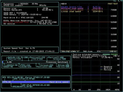

A no name "8517 v3.21", ALi M1217-40 based Am386SX33 board, picked up cheaply, and repaired acumulator leak damage, and some minor damage to RAM sockets.
Added 4x4MB-60ns RAM 30 pin SIMMs, ATI Mach32 Ultra+ 1MB, multi-IO with 256MB CF.
Tweaked timings to max.

Peformance is surprisingly good considering a 16-bit path to memory and no cache. I wonder if your CPU would overclock to 40MHz?

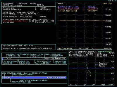

It does...

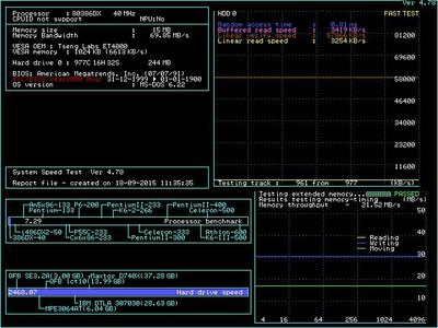

A no name "KM-340IC Rev.H3B", Forex 411/402 based Am386DX40, 64kB cache board.
Added 4x4MB-60ns RAM 30 pin SIMMs, Tseng ET4000AX 1MB, multi-IO with 256MB CF.
