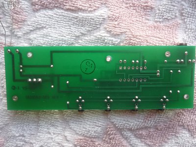

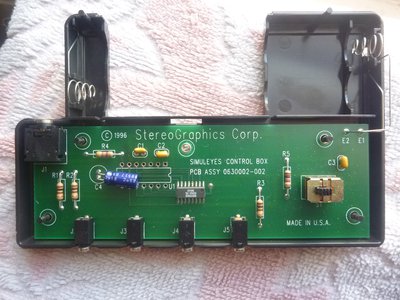

Here are pictures of the PCB:
989.6 KiB
1086 views
SimulEyes Front PCB
1008.9 KiB
1086 views
SimulEyes Back PCB
The IC appears to be a small custom SGC0502 IC. Complete Markings: SGC0502 K04A-7A 9643
R1: Brown-Black-Brown-Gold
R2: Brown-Black-Brown-Gold
R3: Brown-Black-Brown-Gold
R4: (Hard to make out looks like Yellow-Brown-Red-Gold)
R5: Brown-Black-Red-Gold
C1: 638 RAX
C2: 640 RJJ
C3: 104 E5M (ESM?)
C4: 1uF 50v
If anyone needs more pictures of it and want to attempt making one let me know.
