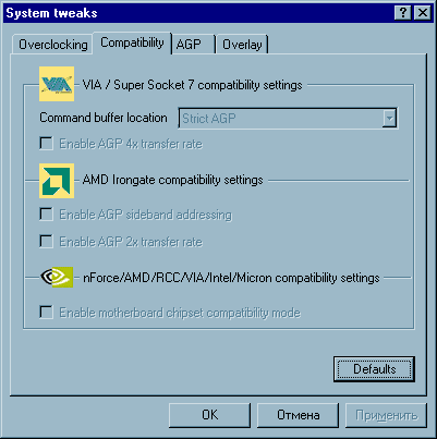

Reply 8 of 17, by Johnylyr
Try this:
I had the same problem back then with my Celeron Tualatin 1400 + Geforce 6600GT AGP in mother nature and the last option solved it for me.
Reply 9 of 17, by PhilsComputerLab
Cool! Would you happen to have a link for this?
YouTube, Facebook, Website
Reply 10 of 17, by tgod
That screenshot is from Rivatuner.
Reply 11 of 17, by PhilsComputerLab
Awesome! I will try that tweak when I do another project to do with the XP CPU.
