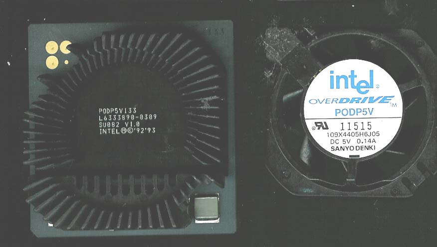

Ive been trying to remove this pentium heatsink for ages but it wont even move a millimeter.
it looks like this:
http://www.cpushack.com/chippics/Intel/PODP/I … elPODP5V133.jpg
But mine is a P1 133 with the fan missing.
Tried heat, pliers, wedging it out with a flat screwdriver, tried to force solvent through. Nothing worked.
I didnt want to go much hotter than a hairdryer, i figured a heat-gun might damage the CPU die. Should i just use more force ? But that might break the ceramic.
What on earth did Intel use to bond the heatsinks on these ? It seems like some kind of super strong epoxy.
Any ideas on what to try next ?

Reply 1 of 17, by candle_86
if its an epoxy they glued with you need something alot stronger but not sure what would be safe to use, I know nail polish remover would break down the epoxy but it might also destroy the chip. Easier solution go to ebay and buy another Pentium 133, they are a dime a dozen

I've removed a few epoxy glued heatsinks in Xboxes using a heat gun back in the days. A hair dryer just won't reach the temperatures needed to weaken the glue sufficiently.
Begin with heating the heatsink up to ~80deg C. Try twisting rather than prying it off. If it doesn't come loose, heat it up another 10 degrees to 90 deg C and try again. Keep raising the temperature in increments of 10 degrees and trying to twist it off until it comes loose. If it won't come loose before 150 deg C, I'd given up and just ebayed a new CPU, it's not like Pentiums are expensive.
Of course you don't do this with the CPU mounted in the socket. Clamp it in a vice, or perhaps use an adjustable spanner large enough to grip the CPU. Remember to protect the CPU from mechanical damage, put some copper or aluminum sheet or something between the jaws and the CPU.

Reply 6 of 17, by Kodai
The epoxy Intel used on the OverDrive line of CPU's is among the toughest I have ever encountered. That goes from the 486's through the Pentium line. Normally I would suggest a heat gun or solder reflow gun, but that type of thermal epoxy is so tough it doesn't help that much. If you live in an area that you can still get some freon then I suggest that. Yeah, the cold temps help make the epoxy brittle, but the freon will also breakdown many types of epoxy (like a low grade acid), and won't hurt the chip. However, getting freon nowadays is both hard and expensive so that's probably not an option. If you do manage it, make sure you do the work outside to avoid the toxic fumes that will build up in a normally ventilated room.
I really can't think of to many options when it comes to the OverDrive chips as they are a real pain in the butt with that super epoxy Intel used. One or two of OD chips had a heatsink that was built into the chip package and couldn't be removed, but yours is not one of those. It can be removed, but it's going to take time, effort, and patience. Careful use of a thin bread knife can provide uniform pressure when trying to separate the heatsink from the package. Thin razors are a danger and a pain with normal epoxy, but almost useless with the Intel stuff. I would just recommend many trips to the freezer and carefully prying with the bread knife. As soon as the chips starts to feel warmer in your hands, stick it back in the freezer for an hour and try again. Might take a few days of doing it that way, but it will work.
You'll have to man handle it a bit, but pay attention and you shouldn't do any damage. When the heatsink finally pops off, then hopefully most of the epoxy will be on the heatsink and not the chip package. If you still have a large amount on the package, you will have to carefully remove it with a fresh razor while not scratching the surface of the package. Again, patience is key. Good luck.

Reply 10 of 17, by SuperHanSolo
Okay its off, I let it get cold like Kodai said, then put in on top of some sofa foam (so i can exert force to pry with bending pins badly) and pried with the biggest flat i could get, a tiny corner gave way then i shoved a smaller chrome vanadium flat screwdriver in that gap. Even after that i had to pry so hard the chrome chipped off the screwdriver but it came off.
Its a wierd glue, dark pink in color almost the same color as the CPU, feels rubbery but its actually fairly hard, if you try and scrape it off with a razer under its top surface it sparkles. I have no idea what this is, never seen a glue like this before but im hugely impressed with its strength. This is some old school industrial sh!t.
