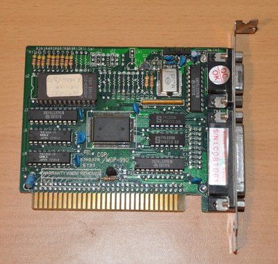

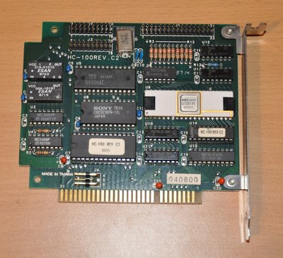

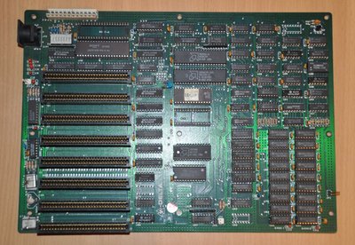

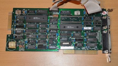

* * * ADDED PHOTOS * * *
Inspected the innards today and the motherboard I installed years ago is an Octek FOX II 286 Rev. 3.4 sporting a 20MHz Harris chip. The battery has started to leak slightly and I regret not getting the system earlier. The hard drive still works but looks like I deleted all of my stuff from back then. A lot of it is still on 5.25" floppies I reckon.
It turns out the computer was bought in 1987 and the most recent files on the hard drive are from 1997. 10 years of use is not bad for such a dinosaur 😀 The hard drive is a huge 5.25" winchester drive and it is quite loud. I always liked the sounds that it made while reading/writing.
EDIT #1: I brought with me a small box of cards (see pictures) but I don't think all of them belong to the original setup. The only one that I'm 100% sure is the Hercules card as it has a custom ROM. The card with the battery is probably also original since the machine had a game port. Anyone have any ideas? There's already a controller inside the machine itself as well, plugged into the 286 motherboard.
EDIT #2: I think I figured it all out. The cards pictured were ALL part of the original setup. The MFM controller that's in the 286 is a 16-bit card so it couldn't have been used in the XT. There's also a dual serial card I probably used during my BBS days because of its 16450 UART. Does anyone know, if 16550 and 16450 are interchangeable?
Reply 13 of 32, by Jo22
Hi, do you mean software or pin compatible ? I think they're both, but I don't know for sure.
I know that OS/2 is picky about which UART chip is installed (it emulates a 16550, so I think this one is preferred), but in a PC/XT this shouldn't matter.
Except maybe some early telecommunications programs from the 80s. They had routines built-in to circumvent certain bugs of the 8250..
I've found some good informations here, here and here.
Don't know if everything I put together down here is correct, though.:
8250 first UART. Works up to 9k6. 1byte buffer
8250A faster version. IRQ bug solved
8250B similar, IRQ bug brought back for compatibility
16450 introduced with PC/AT, up to 38k4. software compatible to 8250 (well, almost I think)
16550 (early) lacks 16byte FIFO (only has a 1byte buffer)
16550 has got a FIFO buffer (first in, first out) of 16 bytes. buggy. 115k2 bits or higher.
16550A common version, for fast modems. 28k and higher. Working FIFOs. sometimes called 16550AFN
16650 modern version, 32byte FIFO, XON/XOFF chars programmable, adds power managment
16750 has got a FIFO of 64 bytes for sending, and 56 bytes for receiving
16850 and 16C850 got 128-byte buffers. speed 460k8 or 1.5 mbps
16950 hi-tech version, found on PCIe cards.
More about D16950 can be read here.
Article Why do I need a 16550, 16650, 16750 or 16950 UART?
Technical specifications on the 16550
Hope this wasn't to much, I think a 16550 is fine for almost everything. Wouln't make sense if the pinout was completely different to a 16450.
If you can, install a socket on the card and put in a 16550. If there are slight modifications necessary, then this makes it easier. 😀
Reply 14 of 32, by Half-Saint
I did some googling on my own and found evidence of XT owners swapping their 8250 for 16550. 16550 is backwards compatible with 16450 and 8250 so there shouldn't be any issues. Both 8250 on my I/O card are socketed so swapping them wouldn't be much of a problem. Still, thanks for the effort, didn't know much about later UART chips 😀

Reply 16 of 32, by Half-Saint
Houston, we have a problem. I removed the 286 motherboard today and installed the XT board. As soon as I switched on the power, there was a loud bang, a spark and foul smell. Of course I turned it off immediately to inspect the damage. One of the red tantalums under the keyboard connector exploded (C8). I removed it and tried my luck again and this time the computer turned on but I got a "Keyboard Bad" error.
Another problem is that for the life of me I can't figure out where to plug all the case cables - keyboard lock in particular. I feel that this could be the problem also. None of the connectors are labeled and none have three pins like the keyboard lock case connector. Tried looking online with no luck.
EDIT: I found the schematics here: http://stason.org/TULARC/pc/motherboards/U/UN … DES-RIS-TB.html
I was able to connect everything except the keylock so I used a jumper on JP3 and now the keyboard works.
Can't connect the floppy drive because I don't have the correct cable and will have to look for it. The hard drive is detected as unformatted and the controller wants to format it. I was able to boot from this same HDD on a 286 using a 16-bit WDC controller so what gives?
