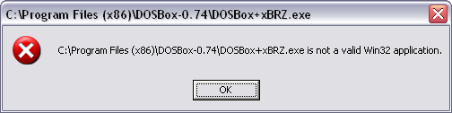

Reply 106 of 109, by mockingbird
Hey Zenju,
Which was the last version that supported XP? Or would you mind re-compiling with XP support please (actually, I'm using XP x64).
I'm getting this error:
8.31 KiB
2902 views
edit: Just want to confirm that DOSBox_0.74+xBRZ_1.2+Save_States_Win32 does indeed work on XP, so the XP target just has to be added for future compilations...
Also, the xBRZ is not something I'm really that interested in, and my computer isn't fast enough for it. Is there a way to run the executable so that I just have the savestate support without xBRZ?
Thanks
