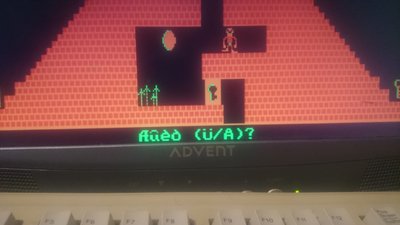

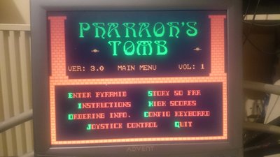

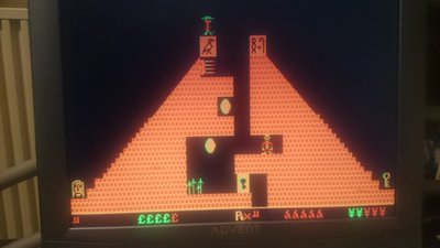

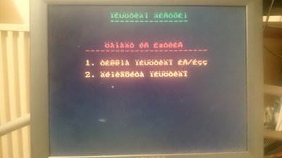

Hi guys I am trying to play Pharoh's Tomb on my Pentium 1 dos machine and managed to get working with slow down software and wondering why some of text is garbled and if there is a fix and try differnet versions and same thing and also try it in dosbox and there are no issues

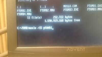

1st pic - what is in game folder (moslo.com is the slow down software)
2nd pic - what I type in to start game with moslo
3rd pic - the main game screen (looks normal)
4th pic - the first level and the text/info at bottom of screen I'd garbled
5th pic - what the text looks like when I quit the game
Last pic - the text on screen looks like when I try to configure a joystick

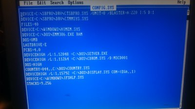

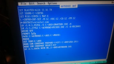

here is pic of my config.sys file and autoexec.bat file
    2.8 MiB
    1284 views
    2.73 MiB
    1286 views
Reply 3 of 16, by Jorpho
So the answer is "yes".
Comment out the MODE lines in your autoexec.bat (just put a semicolon at the start of the line), as well as the COUNTRY line in your config.sys. That ought to fix it.

Reply 6 of 16, by keropi
make these changes:
CONFIG.SYS
;COUNTRY=044 etc etc
;DEVICEHIGH /L:1,15792 =C:\DOS\DISPLAY.SYS etc etc
AUTOEXEC.BAT
put REM at the begining of the last 3 lines
reboot and report back
Reply 7 of 16, by Robhalfordfan
no I not using windows when playing the this, I am using dos 6.22
and those change with the ; at start of the lines in config.sys and rem at start of lines in autoexec.bat has fixed and worked
thanks for help 😀

Reply 12 of 16, by VileR
Robhalfordfan wrote:
what different did that do out of curiosity and would that affect anything else like other games or windows 3.11
The following technical explanation is courtesy of Mr. Halford himself:
The sinner here is DISPLAY.SYS, which (in your case) reuses the upper half of the ASCII table for the UK regional code-page. The modified characters don't go away even in graphics mode, since it acts like a watchful sentinel and re-instates this codepage whenever there's an INT 10 video mode change. So you're basically locked in to a different 8x8 system font.
Now, Pharaoh's Tomb is being a bit of a cheater in how it displays stuff - it messes with the same extended ASCII table to get its different fonts (plus various little bits of graphics). That's why you were getting a raw deal there: all looks good on the main menu, but you've got another thing coming - it resets the video mode as soon as you start a game. That's when the never-satisfied DISPLAY.SYS goes running wild, and sets the font right back.
So the way this game does things is just a bit reckless, even if it isn't really breaking the law; it was simply designed in the US, without considering that some international users may be left out in the cold. So to answer your question, yes, any other game that uses this method could be a victim of changes. That's pretty rare however, so most run of the mill games/software won't be affected.
...hey, don't shoot the messenger. 😁

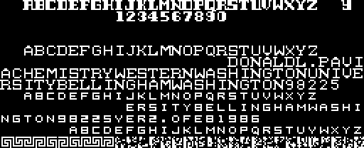

Reply 14 of 16, by VileR
"Random funny thing" corner:
I wanted to verify that I wasn't just talking out of my ass up there, so I had a look at what exactly the game was doing... and this is the data that is referenced by the 8x8 font pointer (while on the main menu):
3.66 KiB
1204 views
Made me kinda curious about what "Donald L. Pavia" has to do with Pharaoh's Tomb, and why his address is in there, so I looked around a little bit. And sure enough, at least that one font is directly ripped from a 1986 release "Alphabet Games", part of a "Kidgames" compilation by Donald L. Pavia. Or possibly from something else by the same author (with the same font)... smooth move, George Broussa(r)d. 🤣
