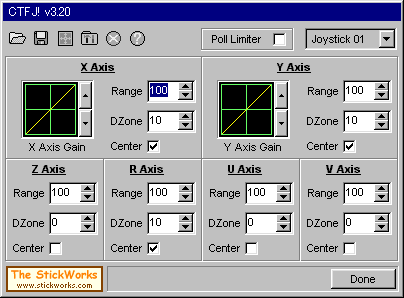

Back in the late 90s, there was a program called CTFJ3 that would allow users to modify deadzones, scaling, gain, range, input curves, etc. Simple and highly effective, it works great for Win9x systems and gameport devices. Sadly, it doesn't work so great with USB devices and NT-based operating systems.
I've been doing some research to try and find something similar to CTFJ3 that will work with modern systems and devices. I haven't found much, but I want to share what I've discovered:
