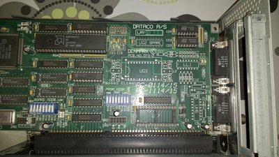

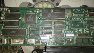

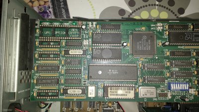

So, I recieved the "Unisys Personal Workstation MPI 4253" machine today, opened it in order to get a closer look at that unidentified ISA card that are in Slot2. And I have absolutely no idea on to what it is at this moment. The connectors are two 15-Pin. One male, one female.
The card are produced in Denmark, and is from Dataco A/S... Hmmm... Danish hardware. Most likely an I/O-Card of some sort. Do any here know what this card is? I have taken three pictures of this card, and attached them.

A NIC:
https://en.wikipedia.org/wiki/AMD_Lance_Am7990
Edit: With some own intelligence:
https://en.wikipedia.org/wiki/Hitachi_HD64180
Thus it's more than a simple NE2000-alike.

Reply 3 of 7, by brostenen
Thanks....
Must be a token ring of some sort. Hmmm... Why the male and female connectors then?
Just strange that the seller had a 3-Com NIC card in this too.
Reply 6 of 7, by keenerb
http://www.exintel.dk/history.htm
Dataco ScaNet adapter?
Looks like it. ScaNet also offered a DES encryption option according to https://goo.gl/apXeLI
The connectors were proprietary and could support several external modules for various networks. Neat card.
Or maybe those are twinax interfaces?
Reply 7 of 7, by brostenen
Yeah.... That encryption option baffles me too. I have been discussing this on G+ as well. Seems like it is just an old NIC that can be used in some sort of secure enviroment.
