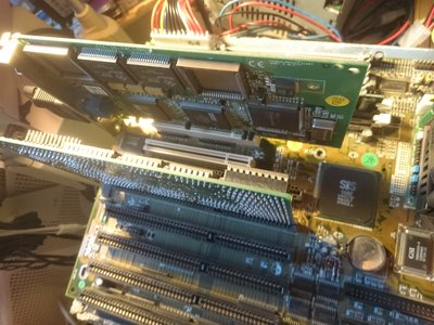

Not getting any younger; need to get these builds finished sometime this decade. So, here is something you don't see everyday:
2.91 MiB
5388 views

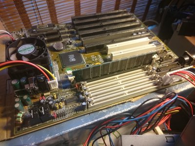

AMD K6-III+, Socket 7 with working Turbo-switch, 6 ISA slots!
3.17 MiB
5388 views

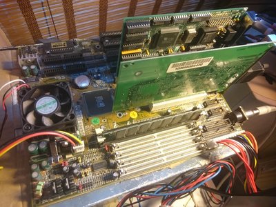

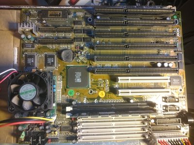

A different angle, SIS chipset, S7 Evergreen Interposer used.

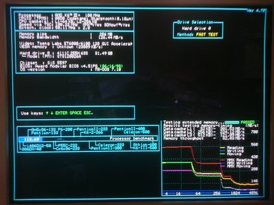

Dual Tsengs - ET4000AX can work alongside its older brother...
2.92 MiB
5388 views
... A Tseng ET6100... and PowerVR PCX2 - aka Apocalypse 5D.

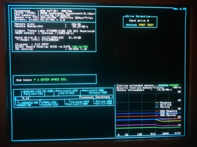

Speedsys:
2.13 MiB
5388 views

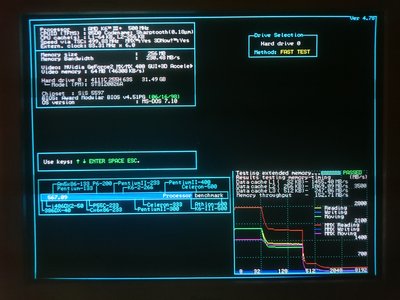

Nvidia MX400 PCI, K6-III+ at 83 MHz FSB, 6x Multi.
So, this is around the fastest this board will go. The board is a Rise R547:
http://www.yjfy.com/R/RISE/mainboard/R547.htm
With the Apocalypse 5D and the Tseng ET4000AX taking up 2 slots, I have 5 slots available. Possibly a Voodoo 1 or 2, and the rest will be sound cards.
So, how slow can this board go? XT 8088 equivalent speeds are possible, covering 6 distinct eras: 8088/ 8086, 286, 386, 486, 586/ Pentium and Pentium II. More 6-in-1 benches to follow...

Reply 5 of 45, by j^aws
^^ Interesting you call this a Super Socket board - how do you define one? I was under the impression that to qualify, the board required 100 MHz FSB capability at the very least, and possibly an AGP slot. And yes, the board is rather unusual.

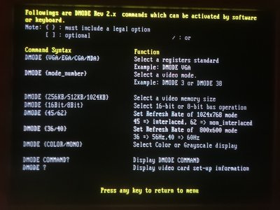

I didn't get too much time for benches, but did try a few. Firstly, I tried an ET4000AX utility called DMODE - anyone try this out before?
1.78 MiB
5316 views
DMODE for ET4000AX
It seems to allow various modes of interest. Of note, the ability to change how registers behave for CGA, EGA and VGA. How good is this regarding compatibility?
Also of note is the ability to force an 8 or 16 bit bus; this comes in handy for slowdown using the video controller rather than the CPU. So you could create a graphics-bound setup instead of being CPU-bound. I managed to get some time to test this board with the fastest CPU settings on a few benches:

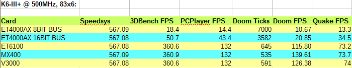

Benches at 500MHz, 83x6.
Added the Voodoo 3000 and Nvidia MX400 for reference. They're in the same ballbark as the Tseng ET6100. Whilst the ET4000AX, being ISA based, is way off the mark, especially when forced to operate at an 8bit bus width. I can safely say it's being 'maxed' out!

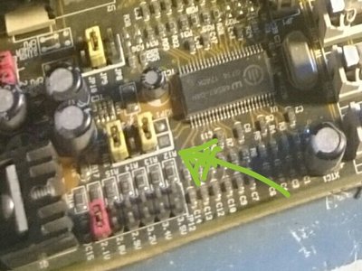

Not only fill in gaps below 386 speeds with 286 and 8088/ 8086, but also fill in gaps around 386 - Pentium 100 smoothly, which isn't possible on a normal K6 setup with a SS7 board.
I can separate between 8088/ 8086 and 286 by using multiple parameters besides Turbo/ Deturbo. Parameters available: FSB, Multiplier, L1 Cache, L2 Cache, L3 Cache, Memory Timings and Latency settings in BIOS. How significant the impact on speed depends on the parameter(s) and the state of the CPU speed. For example, insignificant parameters at high CPU speeds become very significant at 8088/ 8086 speeds.
The lowest FSB currently for this board is 50MHz, however, it could be possible to get more undocumented settings from this:
126.95 KiB
5230 views
PLL Clock Generator and extra pins.
I maybe able to get lower FSBs from the missing 4th pin, JP1. I'm pretty sure the IC next to it is the PLL Clock Generator, but I can't seem to find a datasheet for it. In any case, even at 50MHz FSB x 2 Multi, the board can still downclock to XT speeds, where Speedsys drops below the number 1. I'll see if I can post a Speedsys profile in that range, but it does take an eternity to run at that speed range...

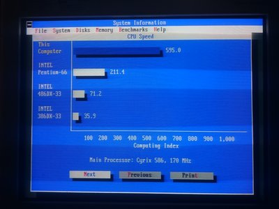

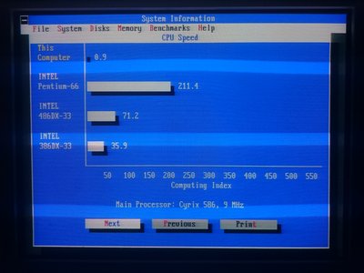

Same config with NSI version 8 (Norton System Information) ~ 595
3.49 MiB
5188 views
100 MHz, 50x2; all caches enabled: L1, L2, L3; Turbo enabled (fast); fastest BIOS timings.
I'll be switching mostly to NSI for benches, especially at the slow end of the spectrum due to it returning results much faster than Speedsys. For the NSI Computing Index:
NSI = 1.0 = 4.77 MHz IBM XT

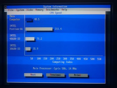

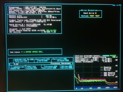

I'll follow this path for slowdown below (there are many paths). By flicking the working Turbo header, and going into De-Turbo mode:
Speedsys ~ 9.26
2.27 MiB
5188 views
100 MHz, 50x2; all caches enabled: L1, L2, L3; De-Turbo enabled (slow); fastest BIOS timings.
NSI ~ 48.5
3.18 MiB
5188 views
You can see the drastic change in the Speedsys memory throughput with De-Turbo. Continued on next page...

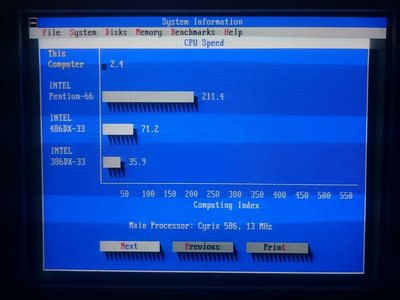

NSI ~ 2.4

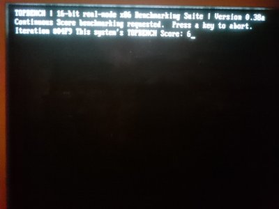

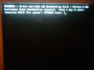

Topbench ~ 6
1.32 MiB
5186 views
100 MHz, 50x2; L1 and L2 disabled, L3 enabled; De-Turbo enabled (slow); fastest BIOS timings.

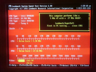

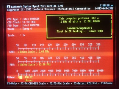

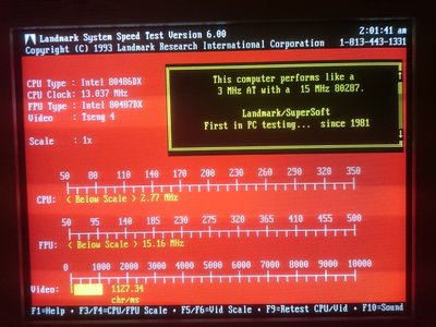

Landmark (ver.6) ~ 5 MHz AT
2.8 MiB
5186 views
You can see that we have approached 8088/ 8086/ 286 territory. The above settings would be one of three baseline starting points to scale using both FSB and Multipliers for various speed profiles.

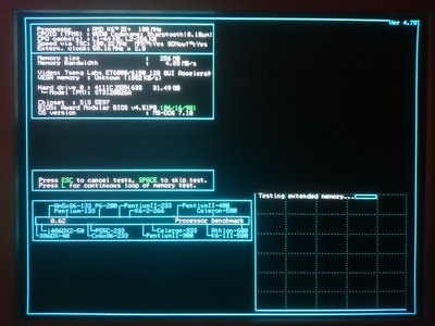

Another baseline config, same as above but with with all caches disabled (L1, L2, L3):
Speedsys ~ 0.62
2.14 MiB
5181 views
100 MHz, 50x2; L1, L2 and L3 disabled; De-Turbo enabled (slow); fastest BIOS timings.
NSI ~ 1.2
3.58 MiB
5181 views

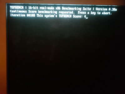

Topbench ~ 4
1.32 MiB
5181 views
Landmark ~ 3 MHz AT
3.24 MiB
5181 views
You don't see many Speedsys scores below 1.0; welcome to 8088/ 8086 territory...

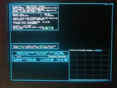

... The 3rd baseline config, same as above but with slowest BIOS timings:

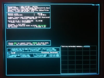

Speedsys ~ 0.45
2.14 MiB
5177 views
100 MHz, 50x2; L1, L2 and L3 disabled; De-Turbo enabled (slow); slowest BIOS timings.

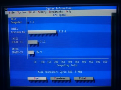

NSI ~ 0.9
3.66 MiB
5177 views
Topbench ~ 3
1.34 MiB
5177 views
Landmark ~ 2 MHz AT
3.58 MiB
5177 views
... With Speedsys approximating to less than 0.5 (0.45) and NSI to around 0.9 - this is 8088 territory. Looking at the last two batch of results, NSI 1.2 and 0.9, I have only adjusted BIOS timings. Tweaking this can adjust an NSI range from 0.9-1.2, and attain different XT 8088 speed profiles. For example, Turbo'ed 8088 XTs and NEC V20s...
Moreover, I have used only the PCI Tseng ET6100 so far in these tests, and if you look back at my earlier post with the ISA ET4000AX, I can use this card for graphics-bound scenarios. I have more options to test, especially using MDA/ CGA/ EGA/ VGA register switching using its DMODE utility...
More will follow later, where I'll scale-up from these three baselines using FSB and Multiplier parameters. This will show a smooth range of speeds from 8088-386...

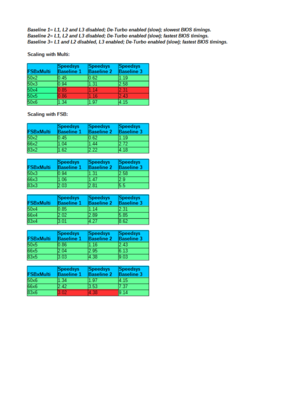

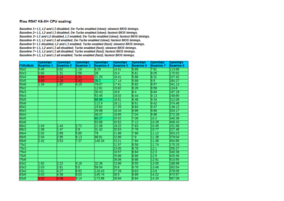

I've been really busy lately, but managed to get some tests done and formatted some datapoints from XT speeds to around a 486 for the time being - outlining the smooth scaling.
You can see both FSB and Multi scaling using the aforementioned baselines:
55.08 KiB
4966 views
The cells highlighted in red are anomalies, where the expected Speedsys numbers are lower than expected. Bizarrely, they are slower with faster parameters...
Next, I've collated the datapoints to show the smoothness in scaling:
57.98 KiB
4966 views

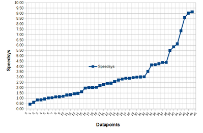

I stopped around Speedsys ~ 9, this is around where I de-turboed with all caches enabled, as seen in one of my earlier posts. The above datapoints have scaled up to just below that speed.
Below is a graphical representation of the above table:
23.17 KiB
4966 views
More datapoints can be added to make the scaling even smoother... So, we've scaled from a PCJr/ XT to a slow 486. Here is the fastest Speedsys snapshot with Deturbo and only L3 Cache enabled:

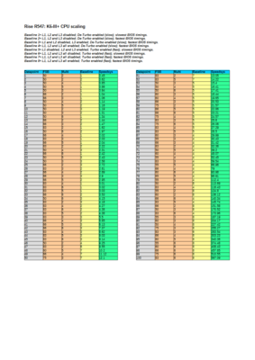

Reply 17 of 45, by j^aws
Okay, some more benches - pretty much an extensive run to continue from where I last left off:
85.93 KiB
4843 views
Above are a range of datapoints for various baselines - so many to fill in! Most are done, especially the ones that return Speedsys results the fastest. I have enough datapoints to fill out a smooth range from PCJr/ XT @ 4MHz to K6-III+ @ 500MHz with plenty of granularity, as shown below:
99.79 KiB
4843 views

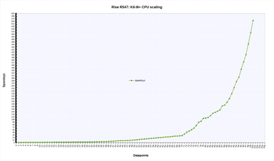

And below is a graphical represenation of the whole scale, with select datapoints:
107.99 KiB
4843 views
Baselines 1, 2, 3 and 4 use De-Turbo as a parameter for slowdown. Baselines 5, 6, 7 and 8 are with Turbo (normal, fast). So 5 to 8 give an idea as to what speed ranges are available for a typical Socket 7 setup without Turbo functionality. As you can see, the whole range is very expansive and smooth, and should be more than adequate to cover a vast range of games...
Need a break form benches for now...
