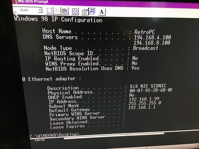

So I've built a Windows 98 PC, everything seems to be working well except I just can't get the darn thing on my home network. I have the drivers for the network card (SiS 900 PCI Fast Ethernet Adapter according to Windows), the network card lights up and is seen by windows and all the lights flicker as per normal when attached to my network switch but it just won't see the router.
I've tried it with and without DHCP, tried manually changing the transmission rate (10 base TX etc, with and without duplex), nothing seems to get it to work.
Here's an ipconfig /all I did on the machine, as you can see I've manually added an address rather than rely on DHCP but still zip:-
2.83 MiB
1263 views
Any ideas anyone? I don't want to surf the web on this machine or anything daft like that, just want an easy way to copy files back and forth between it and my main PC.

Reply 1 of 7, by Deksor
What do you use as a router ?
Have you tried to ping the router with the PC and vice-versa ?

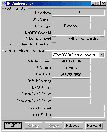

Reply 2 of 7, by Jo22
Win98 also had a graphical tool, winipcfg.

Reply 3 of 7, by BuckoA51
Yeah, no response, and the PC never appears on the network map on my router. It's an Asu RT-AC68U router.

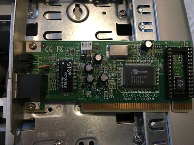

Win98 Should pick up an IP address from any router new or old.
How sure are you that its a SiS 900? Don't trust windows, it'll quite happily report the card is working well in device manager, even if its completely different card and not working at all.
If you are sure try some different versions of the driver, sometimes its a matter of finding the right combination.

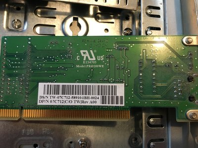

Reply 6 of 7, by BuckoA51
Yeah that's what I thought...
Not at all, I didn't realise that it would do that, here's some pictures of it as pulled from the rig...
2.6 MiB
1222 views
2.52 MiB
1222 views
Googling around suggests it might be a DELL card after all...
https://www.amazon.com/07C712-ETHERNET-ADAPTE … 5/dp/B00B87BJMM
Update - Yep, that's what it was, now working after I found some Dell drivers, thanks everyone!
