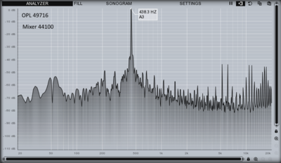

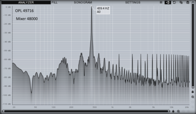

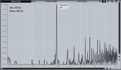

Make absolutely sure that both the Mixer and oplrate set to 49716 in DOSBox config else there is high level of harmonic distortion in the OPL emulation.

Reply 4 of 48, by James-F
No, for the real sound card DirectX (if you are on Windows) handles the sample rate conversion so everything should be right.
SDL which DOSBox uses for audio has far from alright sample rate conversion.
Anything but 49716 on both mixer and OPL, sounds distorted and noisy.
This applies to the Fast/Compat modes as well as for Nuked.
72.54 KiB

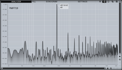

Real OPL3 for reference (YMF719):
115.96 KiB
20064 views
