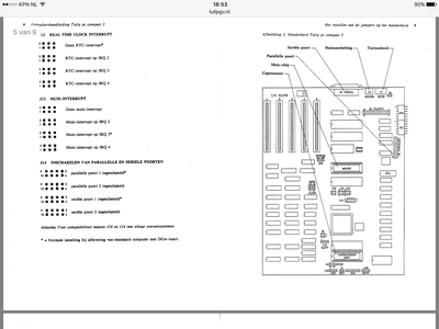

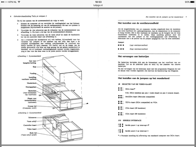

Also check the jumpers on the mainboard. They need to be set acording to the displaycard u use.

Reply 21 of 70, by Cyrix200+
I noticed that as well in the manual, I will check everything tonight. I don think anyone has ever changed the DIPs and jumpers in the system though, but I have to check 😀

I put the jumpers on the card in CGA 40 mode, and also the jumper on the mainboard. I get the same distorted images (and also more beeps during post, but I can't read the screen so not sure if there is an error. This is Norton Commander with the system set to CGA 40:
