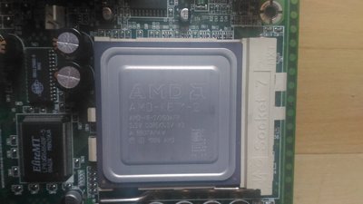

The heart of this PC is an AMD K6-2 with it's 3Dnow! instructions, running at 350MHz.

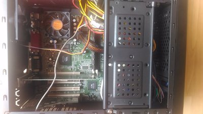

The motherboard is a Mitac 5114vu with VIA MVP4 SS7 chipset. This motherboard contains an ESS ES1989 sound chip and the MVP4 chipset features an integrated Trident Blade 3D, which would have made for an under-powered, yet cheap gaming rig already, however there are no proprietary/rarely used API's for them, so I went with different choices for sound and graphics:

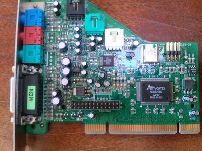

Aureal Vortex 8820 sound card by Turtle beach for A3D sound

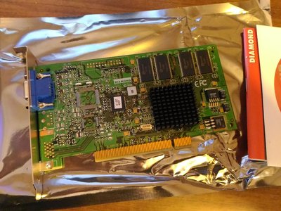

Diamond Stealth III S540 (S3 Savage 4 pro), with its support for MeTal API and S3TC. PCI version since the integrated Trident uses AGP.

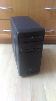

All packed in a tiny modern case - AeroCool PGS QS-182

I like the approach of your build, it reminds me somewhat of my K6-2/300-ish build (which used a K6-2/350 iirc and ran at 66MHz or 75MHz FSB (it was more of a testing rig, so I tried out a couple things on it)), though I ended up using a PCI Blade 3D and I think an ISA sound card? (don't remember which one it was).
Seems your Athlon XP HSF will overchill your CPU, so no problems there 🤣
Only potential problem that I can see is that you used a retention clip which used only the center CPU extension thingy, so a bit of too much force and it may snap (happened even to me once, even though I had been very aware of this exact problem, it happened quicker then I thought).

I actually don't have any smaller coolers for Socket 7 so I was kinda forced to use this one 🤣 I also bent the retention clip a bit so it wouldn't break anything.
I ran Windows 98SE and put it on a 40GB (in 32GB mode for compatibility) Western Digital WD400
