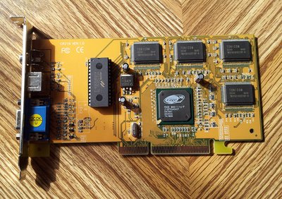

Here's a strange one I pulled out of an old server, a Rage Mobility-P on a desktop AGP card with 8?? MB RAM. Even has composite & s-video out. Anyone know what desktop chip this is equivalent to? Is this card useful for anything? I wish it had the VESA connector.
415.3 KiB
3152 views
Those four cards plus a Thinkpad i-series with another 8MB Rage Mobility comprise the entirety of my Rage ownership experience. It's been pretty good actually.
Reply 43 of 57, by senrew
From wiki:
RAGE Mobility P, M, M1 (RAGE Pro-based) (Motion Compensation, IDCT)
