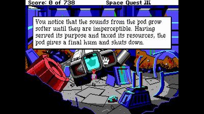

So I thought about trying DOSBox and openglnb output with Nvidia's Dynamic Super Resolution. After enabling it in the driver, I configured DOSBox to use 3840x2160 resolution and that's all you need to do.
I captured it externally and took screenshots with the openglnb at 1920 x 1080, then at Dynamic Super Resolution with the default 33% smoothness and then with Dynamic Super Resolution with 0% smoothness.
To judge these screenshots you must display them on a 1920 x 1080 display in full screen. Windows Photo Viewer does this very well. Right click to download them onto your system, then view them.
The result is pretty good. The image is sharper than using opengl, and the text in the image is much more consistent in terms of pixel sizes in the letters. It looks pretty good!
