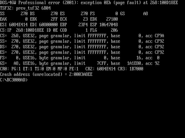

Reply 229 of 246, by Gamecollector
With a real Voodoo2:
Battlecruiser 3000 A.D. 1.07c - "LFB memory map failed, using default LFB address!". Then ctd (dosbox.exe module unknown offset 3fb1590).
Battlecruiser 3000 A.D. 2.0 - same errors. The offset is 2fc1590.
With nGlide 1.02:
"LFB memory map failed..." message.
BC3k 1.07c - page fault.
BC3k 2.0 - module dosbox.exe offset 24236c.
IIRC the last Ykhwong's build which is working with these games is 5 Feb 2013.
    42.86 KiB
    8847 views

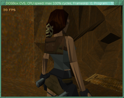

Reply 236 of 246, by arromdee3
Attempting to use this on Mageia Linux 5.0 64 bit (and using openglide), it appears to work, but I do get a glitch: I am playing Tomb Raider. If I look at the main menu, or if I load a saved game, the polygons aren't shaded. However, the workaround is that if I go to Lara's home or start a new game, then return to the menu or load a game after that, miraculously the polygons are shaded and everything seems okay.
I have no idea if this glitch is an openglide bug or a dosbox bug.
Reply 237 of 246, by arromdee3
Unfortunately, I tried Unfinished Business. Unfinished Business has the same glitch that I get on the regular levels. But it seems that my workaround to fixing the glitch doesn't work on UB--my guess is that the workaround depends on the FMVs and UB doesn't have any FMVs. So I'm stuck with no shading making everything look really weird.
Has anyone else had this problem?
Also, I get the following problems:
-- Running and exiting anything that uses Glide results in a black screen or window. I can still type invisibly in it and have my commands executed. (This was also reported by someone else here).
-- In the specific case of Tomb Raider, just going to the menu and immediately exiting results in a black screen. However, if I use the workaround--that is, if I go to Lara's home or start a new game, thus suddenly causing shaded polygons to work--and then exit, it crashes.
Edit: gulikoza solved this problem here but I still get the other two problems, as well as a problem where the FMVs don't work properly in fullscreen (which might not be related to the Glide patch_
