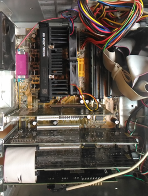

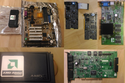

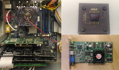

Seeing Voodoo SLI setups beyond the K6 line is a bit of a rarity, so I decided to give it a go!
Motherboard - Gigabyte GA-7IX Slot A with AMD 750 chipset
CPU - AMD Athlon "Argon" 600MHz
2D Video card - ATI Rage128 pro
Sound card - Diamond MX300 with its Vortex 2 chipset
RAM - 128MB PC133
3D workhorse - 2X STB Voodoo2 12MB (using Fastvoodoo drivers)
All powered by a beefy FSP 300W PSU with a strong 5V rail and running Windows 98SE

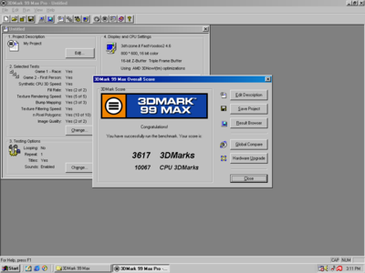

Looks like quite the powerful 1999 gaming rig on paper. The performance?
Unreal: 800x600 - 66.0 FPS; 1024x767 - 53.0 FPS
Quake 2: 800x600 -83.4 FPS; 1024x768 - 67.8 FPS
Quake 3: 800x600 - 44.7 FPS; 1024x768 - 41.6 FPS
3DMark99: 3617 3dmarks, 10067 CPU 3dmarks
53.46 KiB
3449 views
While quite good, the performance is not as good as expected...still below of an equally clocked P3 (used Phil's SLI scaling project as reference)...Is the chipset to blame? Time to fix that in post #2!

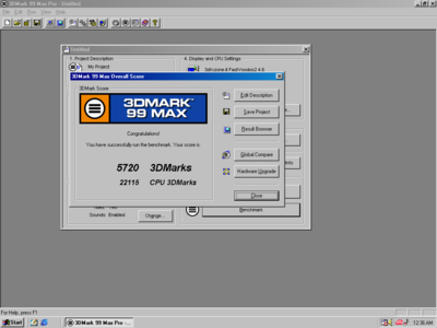

So what would be the best way to boost performance? By upgrading nearly everything! by using my old budget Thunderbird build as the base!
Motherboard - Shuttle AK37 Socket 462 with VIA KT400 chipset.
CPU - AMD Athlon "Thunderbird" running at 1400MHz. No need to worry about the 72W power drain, as this motherboard uses the 12V rail to power the CPU!
2D/3D card - ATI Radeon DDR 64MB. because why not enjoy early 2000s games while I'm at it?
Glide workhorses - the very same 2X Voodoo's
Sound - the same Diamond MX300
RAM - 512MB DDR266
OS - also, the same Windows 98SE
3.47 MiB
3442 views
So how does this thing perform?
Unreal: 800x600 - 91.4 FPS; 1024x768 - 58.9 FPS
Quake 2: 800x600 - 108.2 FPS; 1024x768 - 69.3 FPS
Quake 3: 800x600 - 73.2 FPS; 1024x768 - 46.7 FPS
3DMark99: 5720 3dmarks, 22115 CPU 3dmarks
51.43 KiB
3442 views
Quite the FPS boost @800x600! Noticeable advantage even @1024x768. Even beat the 1400MHz Tualatin! (maybe with some help from the more modern memory/chipset 🤣 )

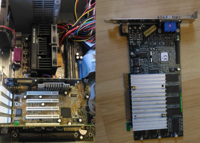

By popular demand, the Slot A Athlon is making a comeback! 😀
Keeping the same 600MHZ Ahlon, Diamond MX300, 128MB of PC133 RAM, but exchanging the Rage 128 and Voodoo2 SLI combo for a Voodoo3 3000!
1.73 MiB
3346 views

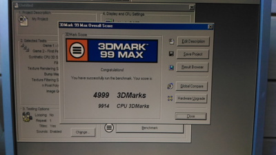

How does it compare against the other two K7 builds?
Unreal: 800x600 - 73.1 FPS; 1024x768 - 57.0 FPS
Quake 2: 800x600 - 113.3 FPS; 1024x768 - 79.9 FPS
Quake 3: 800x600 - 56.4 FPS; 1024x768 - 50.3 FPS
3Dmark99: 800x600 - 4999 3dmarks and 9914 CPU 3dmarks
2.24 MiB
3346 views
Quite the performance boost!
Predictably, Voodoo3 surpasses the Voodoo2's when using the same CPU and actually comes out on top in high-res Quake 2 and 3 vs the Thunderbird build, though the CPU-hungry Unreal still prefers the V2 SLI/Thunderbird combo.
