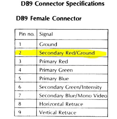

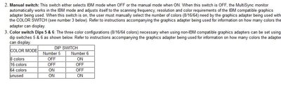

I'll have to do some more research on this. From the manual for the Multisync monitor;
The attachment Capture.JPG is no longer available
With the manual color switch off I get similar colors that I see using the converter. With it on the colors are good. So it would seem that the EGA Wonder does not work quite the same as the IBM EGA card.
check the manual about connecting it to a 5154

The manual for the ATI EGA Wonder states "SW8 off will make the EGA Wonder identical to the IBM EGA in features, capabilities and limitations." But I don't find any specific info about pins for secondary colors. Later I will get my ohm meter out and see if any of the secondary color pins are shorted to ground. It's also possible that the card is showing it's age and not putting out proper signals on one or more pins. I know it does not work at all in Hercules mode although the specs say it should. Maybe it needs re-capping or has another fault. I'll try to find another EGA card to try.
EDIT, I just now found the following in the back of the manual. maybe this explains it?
Reply 186 of 347, by retrocanada76
it's should be grounded when emulating CGA output. otherwise it shouldn't. How SW8 affects the image ?

Reply 188 of 347, by ibmapc
sw8 closed causes the EGA Wonder to go into interlaced mode when 640x350 resolution is selected. This allows ega video to display pretty blurry on cga or composite monitors. I always have sw8 open. Checking with my meter, pin 2 is definitely NOT grounded in CGA or EGA modes. It reads 141 mV in CGA mode and drops slightly to 140 mV in EGA mode. This doesn't seem right. Pin three varies between 150 to 160 mV.

Reply 193 of 347, by Jepael
In the IBM EGA adapter there is a real jumper that selects if pin 2 is wired to either ground or output buffer.
But in this case, it sounds like it's not directly shorted to ground with a wire, but by keeping the TTL output buffer driving it low, perhaps by just setting the EGA palette into 4-bit RGBI mode, or keeping it low otherwise.
Well within specs for a logic zero level (output must drive below 0.4V, input must tolerate up to 0.8V). I would not worry about it.
But I see that there's no pulldown resistors on the converter DB9 connector, so if the EGA card tri-states the unused pins or it is connected to CGA card, the voltages can float at indeterminate levels as there is nothing connected to them. Nobody drives high, nobody drives low. Now, unused TTL input would most likely float at logic high level because of it's internal input structure, but as there is a CMOS chip buffering the video signals it's kind of not recommended to leave CMOS inputs floating. That's why the original IBM EGA monitor had circuitry to ignore unused color and only use 4-bit RGBI when in CGA mode. Which is also the reason that IBM EGA card outputing CGA modes can't use 64 colors.
Reply 194 of 347, by ibmapc
Jepael wrote:
...But I see that there's no pulldown resistors on the converter DB9 connector, so if the EGA card tri-states the unused pins or it is connected to CGA card, the voltages can float at indeterminate levels as there is nothing connected to them.
Well, I took my readings with nothing connected. So, that makes sense. I'll take a reading on pin 2 with the converter attached and active.
Reply 195 of 347, by retrocanada76
This shouldn't be a problem because the sync levels determines what kind of video you are dealing:
H/V Sync: POSITIVE/POSITIVE: 640x200 CGA/EGA-lores RGBI
H/V Sync: NEGATIVE/POSITIVE: 640x350 EGA-hires RRGGBB
Hercules is also NEGATIVE/POSITIVE. This is why a jumper is needed.
The FPGA will ignore the secondary colors in CGA/EGA-lores mode. But yes, in a future version I might add a pull down as well.
