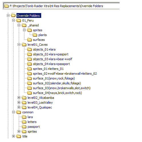

I don't have the time right now to write a detailed "how to" post about the texture management that I'm using, but here's a quick break down.
1) Create a text file in C:\Program Files\Glidos\Textures called whatever you like. You don't even need any of the odd named folders in here, it can be empty except for the text file if you like
2) Edit your text file in Notepad. Here's the start of my one:
[code]
GLIDOS TEXTURE MAPPING
ROOT: F:\Projects\Tomb Raider Xtra\Hi Res Replacements\Override Folders\
// Title / main Menu
BASE: title\
00AE19B7C0B2D045AE54A1683C076786 bottom_left_corner
474C2C91326153751CC40C34817E6800 passport_01
6018E6431FA65017D0F703FC8E60D589 passport_02+mansion+menuring
8880FD9B651C257778549A7EE7A2E450 top_left_corner
8F2FA7061AB2E84279F2292FDD537C46 top_right_corner
9DB0846B3F90F68744D01237BFCE59CB bottom_middle
C1135A3AA842C8E3CDD2493E48CFAE7F bottom_right_corner
E7504AFB7D3264410C74C2EA777AB1F3 top_middle
EFE6179F82CA4471725D4532BC8AA60D letters_01
// Level 1: The Caves
BASE: 01_Peru\level01_Caves\
198EC2D38EF00FEA1653750E8B237D7F surface_01(snow,rock,foliage)
203D6ED9632B742A2209637764C375F6 surface_02(calendar,skulls,foliage)
54637C4BF0304439B63F51D3A5EEA382 objects_01+lara
57A26AB453DED38FE830BB44A64A71F0 sprites_01+letters_01
60812F71A9287004111BA82EF2404371 surface_03(snow,brokenwalls,slot,switch)
6C7FE41E229619C7ACDED8A8538E3F4E objects_02+lara+pasport
708171E626AA342A07B8567EA8A1A53D objects_03+lara+bear+wolf
8B4825478FAB43844E3D4CB077E97613 objects_04+lara+passport
C0B3E0125D1A1A0FF5DBBCA296F8AD4F sprites_02+wolf+bear+brokenwall+letters_02
F7EB7D4BB45372D13AF34500AD82B217 surface_04(maya,brick,switch,rock)
[/code]
3) This file controls where Glidos looks for the data. It builds paths based on values used ROOT + BASE + ODD NAMED FOLDER MAPPING.
ROOT and BASE are pretty self explanatory. The ODD NAMED FOLDER MAPPING is simply the weird named folder that Glidos creates during capturing follwed by a space followed by a folder name of your choice (something sensible that matches its contents, for example)
So, if we take as our example, one of the passport images used on the main title screen:
BASE: title\
ODD NAMED FOLDER MAPPING: 474C2C91326153751CC40C34817E6800 passport_01
Anytime Glidos expects to find an image in folder 474C2C91326153751CC40C34817E6800, it will instead look in F:\Projects\Tomb Raider Xtra\Hi Res Replacements\Override Folders\title\passport_01.
There's one caveat: each time you redeclare BASE, relative paths will operate from the new path. In this way you can collect all data for a level together in one subfolder.
taking it a step further, you can collect mutiple levels together, as I have done (Peru for example).
And a further step beyond that, is to use link files to point to other folders where data common to all levels can be stored.
E.G, in my passport example above, I don't have any image files in that passport_01 folder, I use a linking text file, for example: (72--144)(0--96).PassportPhoto.txt. The contents of this file are:
TLNK: common\passport\passport-photo.png
The path in this file is relative to the ROOT path, it ignores the BASE path. So I put all the passport images in one place, and can link to them using TLNK files from *any* folder I choose. Same goes for any other common data. See the attached screenshot of my folder layout for this to make sense.
Additionally, for wall data, some of it is duplicated between levels. Usually I'll leave the PNG images in the mapped folders, but if the data is common to a numbed of levels, I'll put it in a shared folder outside the level folders. This helps reduce the amount of images needed and is one reason why I'm very keen to release levels in themed packs, all of Peru for example.
I hope that gives you some ideas of how to go about this...
