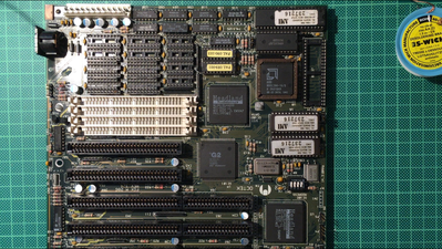

My Fox II blew a cap!
First post, by root42
I have never powered it up so far, so I guess it was faulty...? It was an extremely loud bang.
I can replace the 10uF tantalum, but the question is if itwas the faulty part. I can replace all the caps near the power connector if needed.
Any idea how to troubleshoot this?

Reply 1 of 25, by Deksor
Yeah that's how tantalum caps die after a while. Replacing them is a good idea.
I have an MFM Western Digital HDD in my 8088 and some caps were making short circuit, preventing the whole computer to power up. Once I desoldered them, a third one exploded. Then I decided to replace all of them and the HDD was fine.
So check the continuity of the other tantalum caps too, they might be shorting

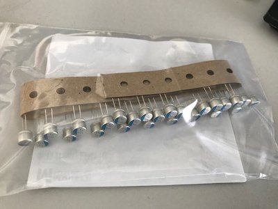

The Nichicon replacement caps arrived! Now cross your fingers that nothing else blew. Those caps looks really nice! 10uF, 25V, replacing the 30 year old 10uF, 16V tantalums.

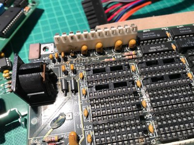

So I now replaced the 10uF caps on the mainboard. I think I did an okay job, and I double checked all solder joints. The board won't boot. I get four beeps when I have RAM installed, and 3 beeps when not. The four beeps seem to be the system timer error. I have never encountered such a problem.
Any ideas and hints what this means and how to fix it? I guess that means some IC on the board is fried? Which one and how can I test this?

Update: I double checked, and found out I forget to recap C54, which was unpopulated after my decapping. 😀 However, I still get the system timer failure. So I am still scratching my head... How can I debug this, which IC is the problem, and can I test it?
YouTube and Bonus
Reply 19 of 25, by quicknick
SW2 must be set to OFF position, otherwise the board is expecting the RAM to be in the DIP sockets not the SIMM ones. I'm attaching the manual in case you don't have it.
