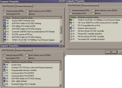

Hi skitters, many thanks for your prompt and detailed reply!
I have attached the IRQs list, it seems IRQ 7 is empty, and that should be perfect for dos-gaming, as few DOS game titles such as Prince of Persia requires IRQ7. I'd like to move the soundcard (This is an onboard card on IBM), to that IRQ.

When the sound card's IRQ changes to 9 or 10, is there something other than the printer that takes IRQ 7 and pushes the sound card onto something else? The printer should be able to share IRQ 7 with sound.
It seems there is no printer port in the IRQs list? I have disabled Serial and Paralel ports in BIOS, to free-up some IRQs, I won't be using those ports at all anyway.

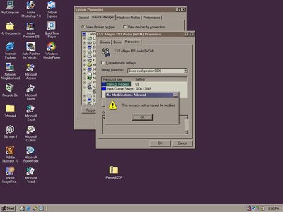

I notice in your bottom picture that it's set to Basic Configuration 0000 on the Resources tab.
Try using the dropdown box to set to a different configuration
and see if that lets you use IRQ 7 instead of IRQ 9.
I don't really know how ESS drivers work for DOS, but it's possible the main card is on IRQ 9 while the emulation, if it were enabled, would be on IRQ 7 or IRQ 5 (similar to what an SBLive might do).

Reply 5 of 13, by deksar
Only "Basic Configuration 0000" exists there. There isn't any another option under the dropdown box there.

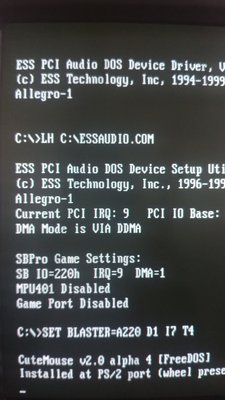

Defining values like "SET BLASTER=A220 D1 I5 T4" doesn't really change the actual values I've posted here during Windows 98 boot post. I'll give it an another try then,
Thanks.
Edit: I've added "SET BLASTER" line into autoexec.bat file to set it as IRQ 7, however as it's seen on the attached screenshot, the IRQ didn't change, still remains as 9.
