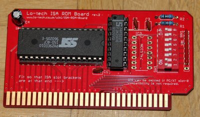

Now I received and assembled my Lo-Tech board.
The attachment IMG_9692.JPG is no longer available
Unfortunately I didnt see I got an Rev.3
https://www.lo-tech.co.uk/wiki/Lo-tech_ISA_ROM_Board
while ordering parts for the older one.
https://www.lo-tech.co.uk/wiki/Lo-tech_8-bit_ROM_Board
I have the following differences:
- SN74F521N instead 74HCT688N: are exactly the same
- 74LS33N missing: Only needed for slot-8
- 7-pin instead of 8-pin resistor network: pin 8 seems not to be connected, therefore no problem
I use the board with a SST28EE010 instead of SST39SF010A. Both have same capacity and pinout. I am programming it in my TL866 and it can be read as SST39SF010A, therefore no problem?
The whole setup works perfectly when using "32KB Address Mapping".
But I dont see anything when using "64KB Address Mapping". Of course I filled the whole chip with data while testing.
I tested with a 32KB BIOS image in 32KB mode and put it to C800. It is read correctly at this adress. I removed the mainboard BIOS, set the DIPs to F800 and...nothing 🙁
Can somebody confirm it is possible to boot a mainboard with the BIOS located on the Lo-tech and not the mainboard..?

Think I have found the reason. My card behaves quite "unusual". Put it in my 286 and played with the jumpers while watching with debug.exe where the ROM appears.
Regardless of the Jumper setting, it is at E800:0 in an 32KB window. Only when switching J5 it goes to C800:0. Didnt notice that as the C800:0 was the setting I intended to have at the beginning.....
Therefore I dont need to be surprised that it doesen boot with F000:0.
Think the reason must be that resistor network...?
This could be a motherboard architectural limitation, in the PC/XT board for example the board will work at F000h only in slot 8 because the system board is hard wired to access the BIOS on that side of the bus.
Reply 14 of 14, by pearce_jj
I had chance to have a quick look at the 5150 schematic. To run the system BIOS from the ISA ROM board, a small mod is needed as the board will drive the ISA bus with u13 for any address in F segment. It looks like a solution is to bend out pin 5 on u27 (74LS02) and jumper this to 5v via a 10k resistor. This will prevent the /ROMADDRSEL signal driving the gate. See schematic sheet 5 for further info. Don’t mod u64 as the signal itself is needed to suppress the RAM chip select signals as well.
In the 5160 this is not necessary as the board can instead be put in slot 8, which as it happens is already connected to the same bus as the system ROM chips. In that configuration, the board should be set not to generate slot 8 signal incidentally, since it is already driven by system board logic.
