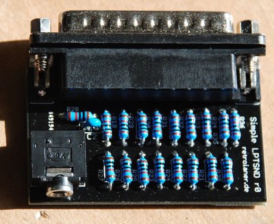

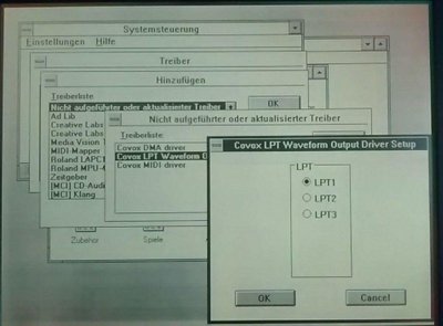

Reply 3 of 5, by matze79
If you need Wave Audio for Windows 3.1 just use a Covox DAC.
I assume your device has no legacy audio, but does it have a LPT Port ?
215.01 KiB
3066 views
73.1 KiB
3066 views
i can build you one if needed, for cheap.
USB Mouse and Keyboard already works via BIOS Legacy Emulation. Also on proper Implentation its possible to use USB FDD on DOS/Win 3.x
At least on my Board i can load PS/2 Drivers for the USB connected Mouse.
