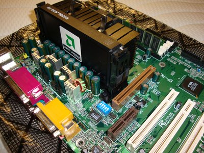

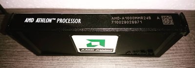

Is anyone here, that can run the fastest Slot A CPU with a Epox 7KXA Mainboard? I know that the VIA KX133 officially doesn't support Thunderbird CPUs, but I can run the current 750Mhz Version of the T-Bird without any problems, and if I install the 1 GHz version, the system hangs all the time, also with another PSU, VGA, different RAM modules and slowest bios settings. No changing!
I have searched in the web and found this:
The only VIA KX133 mainboard that works with all Thunderbird CPUs is the Asus K7V-T. Not the K7V Rev. 1.01 version without -T!
Normal KX133 boards are working stable with max. 800 MHZ Thunderbird Slot A CPUs! But no all, some only run with the classic Athlons, like the Pluto, Argon or Orion with external cache.
The K7V-T is the best performance based board for Slot A systems, better than AMD-751 based boards, like the Asus K7M. I also have a K7M, but with old Chipset revision C4, that doesn't work with Super Bypass Mode, so I don't want to use it. With this boad, the CPU runs perfekt!
So the only I can do, is to find a rare Asus K7V-T for 1GHz Thunderbird compability and one of the best performed mainboards for the Slot A. Will be hard to find as the 1 GHz T-Bird, but that is the only I can do. 😒

Reply 1 of 20, by PcBytes
Replace ALL the capacitors on the motherboard (except the 100uF and smaller). The caps on this board (TAYEH brand) are well known to go bad without any visible bulging. Same goes for the others (I'm seeing Hermei around the AGP slot)

Reply 3 of 20, by feipoa
When I compared various Orion slot A's on a KA7 motherboard (based on VIA KX133), I noticed that the 1 GHz Orion kept hanging up. When I swapped out the heatsink for a heavy copper monster with noisy fan, the 1 GHz Orion stopped hanging. Perhaps your issue is cooling related; or perhaps not. Worth a shot if recapping doesn't help, though, if 800 MHz works fine and 1 GHz doesn't, makes me think the issue is related to the CPU/cartridge/cooling.
By way of similar comparison, my dual coppermine slot 1 board would work flawlessly with 850 MHz coppermines, but not 1 GHz. Perhaps there's something w/motherboard timing that doesn't tolerate the quicker response of the 1 GHz chips, or perhaps current draw of the faster chips is too much for the motherboard's VRMs. Might want to check CPU current requirements and lookup the VRMs on your motherboard. Sometimes they can be replaced with beefier VRMs; sometimes not.
Reply 4 of 20, by NostalgicAslinger
It has nothing to do with cooling, because the Asus K7M 1.04 AMD-751 that I also have, works without any problems with the 1Ghz T-Bird. It is a timing issue with KX133 based boards. Here are some infos: https://arstechnica.com/civis/viewtopic.php?f=8&t=1069330
I will get a Asus K7V-T VIA KX133 mainboard with official Thunderbird CPU support and will post, if this solve the problems. Toms Hardware also says, that the VIA KX133 doesen't like T-Bird CPUs, but some boards can take it. The Epox 7KXA 0.4 for example can run a T-Bird with max. 800 MHz.

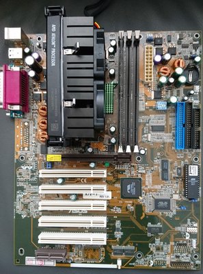

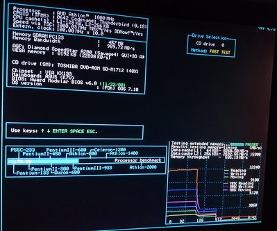

Asus K7V-T mainboard arrived and now it runs fine with the 1 GHz Thunderbird in the first test, also Prime works fine after a few hours, also with 1 GHz and undervolting to 1,75@1,60V. 😀
