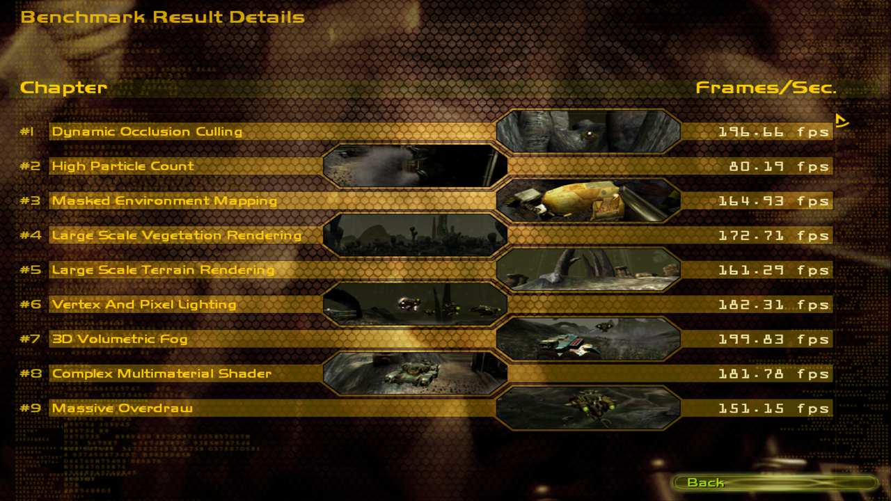

Benchmark in Aquamark 3 (B3D9 tweak + nvidia game profile removed from the game/application profiles DB / application name modified)
dgVoodoo2:
MS:
Why the gamma/brightness is different? (take a look at the fullscreen *PNG* image) It's about some texture format management?

lowenz wrote:
Hi Dege!
Did you see in my benchmark report screenshots the performance *pit* in the "High Particle Count" test of Aquamark3? Any hypothesis about?
Yes, the same low performance in 3dMark2001 for point sprite test. I still have the initial implementation for that, but didn't look at it what's wrong with that.
