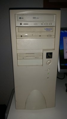

Hi guys I found this one at the flea market today

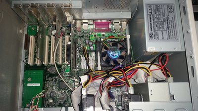

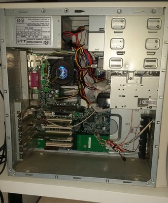

Intel 845WN, Pentium 4 socket 478 1.5GHz, Geforce 2MX 200

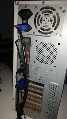

I was quite pleased to find this beige tower 😊 It has some parts I not seen in a while. It has a Plextor CD Writer, and I thought it was really interesting to find an ATX PSU with a mains power pass-through for a monitor. I don't recall seeing that before, the monitor power connector seemed to disappear along with AT power supplies though i never understood why. At first glance I thought this was an AT supply in an ATX case!
Are these ATX PSU with power pass through actually rare?
Oh it also has PCI IEEE 1394 card though I'm not sure what use that is.
One AGP and 6 PCI slots seems very generous! Also there is this funny little slot that looks a bit like PCI-e 1x. According to the manual it is a 'CNR' slot and there were modems and sound cards made to fit it? Never seen one myself and a quick look on ebay didn't show any result for CNR sound cards.

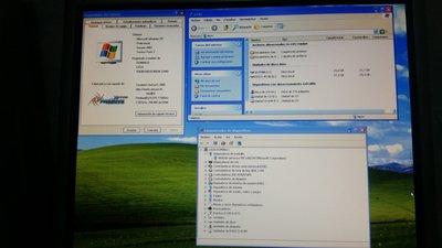

The PC is working fine by the way, has a 20Gb and a 40Gb IDE drive - I am thinking to put win98 on one drive and winXP on the other and select boot in the bios if I can. Only thing I will say is XP seems to be running quite slowly not sure if it is clogged up with software tasks or it's due to having 256Mb SDRAM. Guess a clean install will prove that one way or the other,
Could I make a good Win98 and XP retro gaming PC from this? It cost me all of 10 euros. I didn't bother to haggle 🤣

Hmm I wouldn't call a ATX psu with a pass-through socket "rare" but more like uncommon.. (I had some of these, I believe but ICBW that they were made during the transition from AT to ATX, in a way in the same period where those mobos with both AT and ATX power connectors were made.)

Difficult to make work sensibly with soft-power-off/on.
For all your turn-of-the-Millennium vintage DV Firewire camcorders. Seeing as the Nokia 3210 couldn't film you needed one of these.
They were quite popular with OEMs as they could be cheaper than a PCI card. Look for the Aztech CNR2800, a well-known auction site is crawling with them (for low prices, as nobody wants them anymore). Theoretically CNR could support audio or LAN too, but every board with AMR/CNR/ACR (three slots with same purpose) had onboard audio and I can't say I've ever seen a NIC on one in the flesh, so basically they were only used for analog dialup modems, and died out as analog telephony did.
Very, very rarely you see an Intel PRO/100 VE (aka CNLA6000) CNR NIC for sale, which made marginally more sense, however they were never cheaper in retail than a PCI card and by this time the need for so many PCI slots was dropping anyway.

The parts are not unusual. They were produced in large numbers, and are nothing that special. Look at it, as a kind of run off the mill machine. The standard configuration of it's time. Regarding the PSU, then I did see a lot of those cheap flimsy cases from around 2003/05 that had PSU with it as standard. Like Codegen and stuff.
Not sure I can see why it wouldn't work sensibly - seeing as monitors also have soft power off/on these days. The pass through was always useful as it saved the need for an additional mains socket - and we all know you can never have enough of those! In fact even many CRTs had a standby mode with no video input so the monotor would still go to sleep when the PC shut down.

Looks like a decent motherboard. Replace the president Macron PSU with a new mid range or better Seasonic or bequiet PSU, replace the CPU cooler with something quiet, install something like a GF4 Ti4200 graphics card, add a module of RAM and off you go 😀
