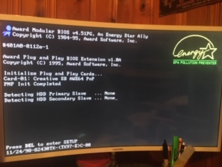

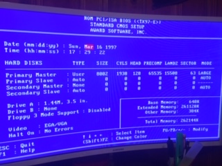

Mobo is asus tx-97-e. This is a project computer i have been working on for a while. I recently replaced about 4 bulging caps on it. However i can still not get a full hdd recognition and start DOS instillation. The bios is detecting the hard drive but it hangs in the self check when searching for ide drive. I am using an 80 gb drive which is set to master on its own ide channel. I have limited the drive to an 8gb partition fat 16 format. I had read that older machines sometimes have difficulty with larger drives over 32 gb and that DOS will not read anything above 8. The bios is detecting the drive and its limit. Not sure what to do.....

The 32GB limit is a bug common for socket 7/slot 1 era. BIOS made before 1999 will have the bug and will hang when a bigger drive is detected. There are several ways of solving this : - update the bios to a newer version (the tx97 must have one)
- Set the drive to a incorrect geometry in the bios and install Ontrack disk manager
DOS 4 to 7.0 cannot read over 8GB indeed. However DOS 7.1 can read FAT32 partitions, so you can use that instead if you're not willing to run windows 3.11 (which can be run if you patch one DOS file), you will get a total access to the drive
Also, you don't need to make your own FAT 16 partition, FDISK will just ignore anything beyond 8GB. Also a single 8GB partition in FAT16 is incorrect for DOS use. Biggest partition possible in DOS 4-7.0 is 2GB, but you can make 4 of them to have access to 8GB, so you'll need to re partition your disk.

Here are some photos if it will help anyone.

You can get a patched bios here that will let you use big HDDs (up to 128GB) : http://www.win3x.org/win3board/viewtopic.php? … 30&f=16&t=26232

Well the latest bios seem to be from 1998, so it's still too old ... There's a patched bios in the link I've posted, this should give you the ability to use any drive up to 128GB.
Yes this is 8GB by stacking each partitions, one partition can be 2GB large at most in DOS 4-7.0 and there's a maximum of 4.
IDE to sata controller would probably work, but it's kinda overkill for such a computer, and sata drives smaller than 32GB must be very rare, except SSDs perhaps ? A IDE to SD card would work very well for your needs !

UPDATE!!! VERY HAPPY CAMPER!!! Thankyou guys especially you Deksor.
This ended up working more or less. It got me past the post hang and I was able to create a partition with Fdisk and install DOS and the DOS started pack.
