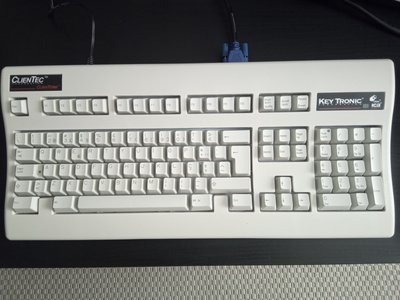

Just came across 4 old ClientTec Citrix ICA terminals. At first I mistooked them as old AT keyboards, but at a closer look I immediately identified as all-in-one thin client, the looks of like I hadn't yet seen.
Probably using it as intended would be fun enough (http://toastytech.com/guis/remotecitrix.html), but I had to dig deeper into this "rabbit hole". It turns out that the PCB that integrates all functions of the thin client has at is core a AMD486-66 integrated SoC.... So, a 486 + a vga from CHIPS + NIC from crystal, 4MB ram and 4MB flash.

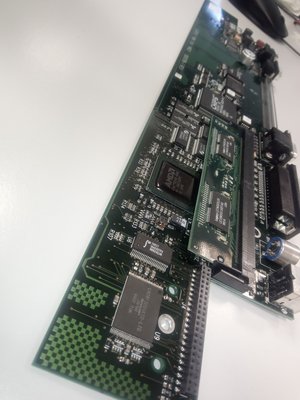

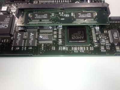

Researching the known applications of AMD SC410 I discovered what once was (probably) the world smallest 486 (http://www.reviewsonline.com/articles/962097916.htm).
Obviously all software is contained on the Flash 28F320, and probably also the bios, at the top addresses. After trolling a bit whit it I noticed this:
The attachment IMG_20190422_155254_sml.jpg is no longer available
....... B:\int.stu ..?!?! Maybe somehow there's an emulation of a floppy or better yet 2.

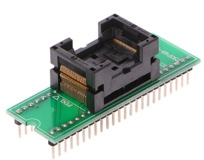

Ordered this from china for my programmer:
The attachment Tsop48.png is no longer available
Let us see what treasures are hiding in that flash, and ultimately, if we can put the damn thing running something more appropriate for Vogons taste 🤣
Nice find, those look pretty cool!

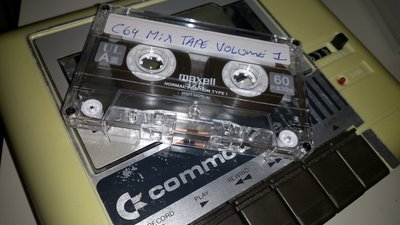

Just finished creating this little thingy...... 😜
Games saved as Turbo loader, so I have placed ABC-Turbo as the first. So far 16 titles are on the SideA.
The attachment First-MixTape.jpg is no longer available
Just to make it awesomme, I used a real Commodore64 and a program to copy.
Everyone else, seems to be using tape deck recorder and a Windows machine.
I wanted to do it on a real C64, and to prepare the files, I used a Linux machine.
Midnight Commander are so cool, as I can extract PRG, as if D64 were a Zip file.

Does this datasette really eat chromdioxide tapes well?
Back then on the PET 2001 I had to take care that it were normal fe tapes.
As the cr tapes were like HD diskettes to "normal" density drives, sometimes too hard to magnetize them sufficiently marginally.
And yes, MC is cool. Though I wish it could use the shortkeys of original NC, like alt+letter or ctrl-pgup.
I don't know what is called what. It is Type-1 tape, so I think it is what Hifi owners refer to as low grade.
As for me, then I had no issues with the recording quality on my system.

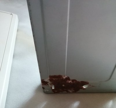

Have to take care at these few positions to my old COLANI Tower.
It's little corroded, and i have to handle this with some rust remover.
It's my first corroded case i've bought the last time. Hope it will be better later.
