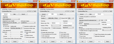

I'm owner of the GOG version of the 1995 fps game Killing Time. Until a few days I had problems with some ingame cutscenes not working correctly. An error message would popup when the game tried to play one of those ghost ingame cutscenes. I tested the game now with dgVoodoo 2.55.4 and it magically fixed this ingame cutscene problem. They all work fine now. The game itself works fine too. :)
However, a different problem that was not there before suddenly appeared. The intro and ending video files are looking totally broken now when dgVoodoo is being used.
Here is an example of how the intro does look when I use dgVoodoo 2.55.4 with the game: https://streamable.com/gmthp
I was talking with GOG support the last few days trying to make the cutscenes work but no luck so far. All videos are AVI files and the codec used for the currently broken videos (KTINTRO.AVI, BADEND.AVI, ENDGAME.AVI, GOODEND.AVI) is called "Cinepak" while the ghost video files (GHOST01.AVI etc.) are using the codec "RLE". Does dgVoodoo have a problem with this "Cinepak" codec? What could I try to fix this problem? Any help with this problem is much appreciated. I attached a screenshot of my dgVoodoo config for Killing Time. The system I'm running the game on is Windows 7 (64 Bit).
Kind regards
Berzerk

Reply 1 of 6, by Berzerk
So after trying some things I figured out that the D3D8.dll, D3DImm.dll and DDraw.dll are causing the trouble with the cutscenes. If I remove these dll files they work normal again but then ingame the ghost cutscenes are not working here and there (an error message wil pop up). Leaving them inside the games folder fixes the ingame stuff but breaks the intro and ending cutscenes. This is really a mystery I think I can't solve without any help. So please if you can help me.
Reply 3 of 6, by ZellSF
https://sourceforge.net/p/dxwnd/discussion/ge … thread/6a89ebe6
I'm guessing the video playback library calls ICGetDisplayFormat , not sure if that's fixable by dgVoodoo (Directdraw not being what does something wrong) or if there's some workaround that will work with dgVoodoo.
Should work fine in DxWnd with the right settings.
