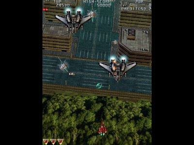

Oh I get it. It's the GOG build that's broken. Somehow. Everything about it seems identical to the original Asian versions of the game down to having the same compatibility problems, but apparently it's a huge difference for dgVoodoo compatibility. With an Asian copy of the game it runs great with resolution forcing and MSAA (don't force texture filtering though):
739.16 KiB
2796 views
Needs GeForce Ti 4800 set as virtual GPU or will have lots of graphic glitches (of a different kind than the GOG build. Also the GOG build will just crash if GeForce Ti 4800 isn't set). I'll definitely test the entire game soon.
Curious if the Type X2 version of Raiden IV (and Raiden III) will work, though that's a pain to get running at all (Type X2 is a Windows based arcade machine).
Edit: tested the first four levels and found a bit of a problem that becomes painfully apparent at level 4. When an enemy is seriously hurt it's supposed to blink orange, but with dgVoodoo it blinks black. You can test it by hurting these ships (the big ones) at the start of the first level:

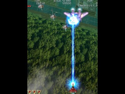

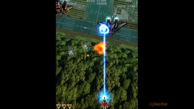

Slightly more on Raiden 3, firing a blue laser makes the issue easier to see, and screenshotable. dgVoodoo:
570.81 KiB
2755 views

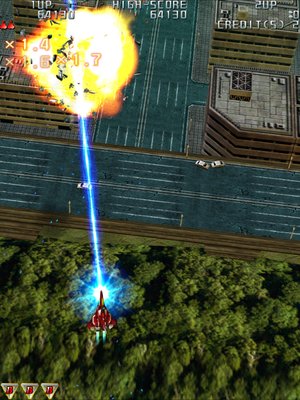

Native:
64.95 KiB
2755 views
Not orange because it's a different kind of effect, that's also wrong with dgVoodoo.

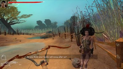

Disciples III: Renaissance demo still has major lightning issues (figured I would check if it was fixed since WIP54, which was last I tested it).

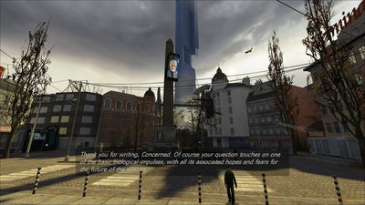

Half-Life 2 is starting to look extremely good. Menu is problematic (cursor issue), but being able to play the game at high resolution with readable subtitles/UI is very nice:

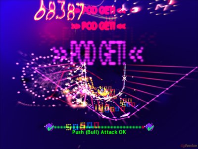

Space Giraffe works, resolution forcing is weird. Setting a lower resolution in-game is required to get a sharper picture. Improvement over native. Not a good game, just figured I test it since it was apparently in the hidden section of my Steam account.

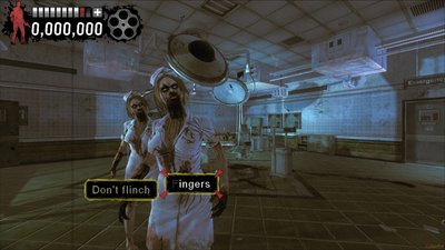

Typing of the Dead: Overkill black screens if anti-aliasing is turned on in-game, otherwise works. Resolution forcing might work? I mean this does not look like native 4K to me:
707.44 KiB
2640 views
But it also looks much sharper than if resolution is forced to 1440p (and I'm testing on a 1440p monitor).
I would say maybe it's increasing the rendering resolution before compressing it down to the size it's supposed to render at, which is 720p, but the image looks much sharper than that too. Maybe it's just the heavy post-processing and low resolutions assets that are confusing my eyes. At any rate, it looks a hell lot better than running the game natively, where anti-aliasing didn't even appear to be working when enabled.

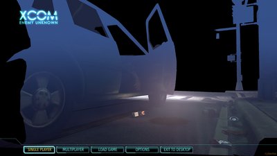

X-COM: Enemy Unknown has some obvious issues:

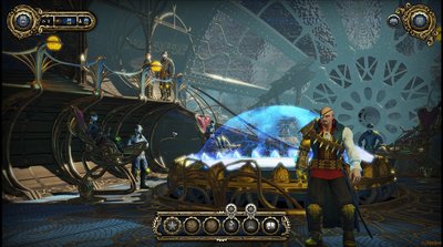

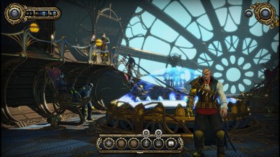

Divinity: Dragon Commander starting a campaign immediately reveals one rendering error:
282.13 KiB
2329 views
Supposed to look like this:
257.75 KiB
2329 views
Resolution forcing doesn't work (mouse issues), was hoping dgVoodoo could make this game work properly in 4K. Not that the game is that bad with resolutions anyway, it works fine at 3440x1920 and GeDoSaTo can be used for sharper scaling.
HL2 is working? How do you run it? I experimented with various -dxlevel options but more or less polygons are always missing. I don't really like that game.
Just the latest Steam version and AdapterIDType = nvidia (otherwise shadows max out at medium and Wallace Breen monitors are wrong). Of course, I didn't test extensively at all. That screenshot is how far I played. Saw nothing wrong though.

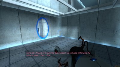

Same with Portal:
623.5 KiB
2141 views
