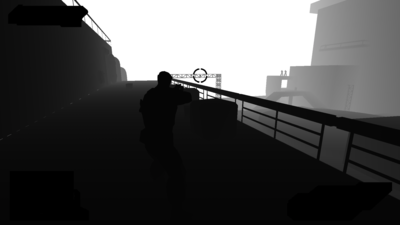

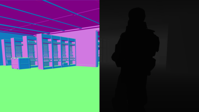

Reply 1017 of 1111, by JJXB
Okay, this is odd. initially RS Vegas 2 didn't pass depth info through WIP59_1 into Reshade and i was going to report that. then i go to test CT Special Forces and it did. so i went back to get screenshots of it not passing depth data through WIP59_1 in Vegas 2 and now it does. Make of that what you will but i'm just confused now.
CT Special Forces Depth through WIP59_1
541.45 KiB
2080 views
Vegas 2 Depth with D3D9 Passthrough:
708.79 KiB
2080 views
Vegas 2 Depth through WIP59_1:
705.14 KiB
2080 views
