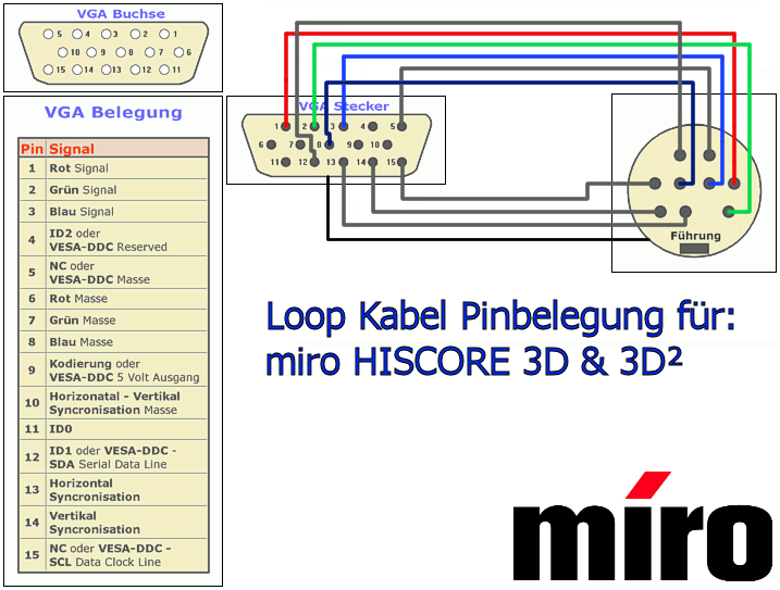

So after finding that Canopus Pure3D II Voodoo II 3Dfx card in a pile of PCI cards Luckybob informed me a proprietary VGA pass-through cable was still needed to complete the kit. They are pretty much nowhere to be found online that I could see. So I went back to where I found the card hoping to find it. After an hour of searching, success! I was hoping some of you could help me identify a very similar cable I also found next to it. The cable on the right in the first photo is for the Canopus Pure3D II card, but the one on the left has an extra pin. Any ideas what this might go to? Both have a male VGA connector at the other end which the second photo shows. Thanks for any help.

The pin arrangement on the bottom row isn't the same, so be careful not to plug the wrong one into the wrong card. Beyond this, while I have many MPEG cards, I have never had the pass-through cables needed to use them, nor felt inclined to construct them myself, in spite of my useless electronic engineering degree.

Yes it appears the 10-pin connector could really be for anything. Just glad I found the 9-pin Canopus cable. Even though this site specifies the female version it at least narrows it down for me that the 10-pin cable is more than likely not for a 3Dfx card.
https://connector.pinouts.ru/10_pin_mini-din_female/
Reply 11986 of 31842, by Arctic
In case anyone is still looking for a way to make a canopus/miro cable:
