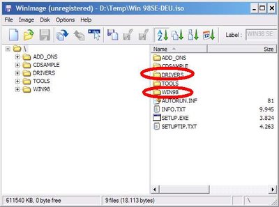

I want to create a folder on the C: drive (eg C:/cab) so that the PC never asks me to insert the Windows 98 CD again when I install some new hardware or plug in a different type of mouse or monitor, etc
Which folders do I need to copy from the Win98 CDDROM to the C drive folder?

Reply 6 of 7, by Jo22
dicky96 wrote:
Which folders do I need to copy from the Win98 CD-ROM to the C drive folder?
- DRIVERS
- WIN98
That's all. Now you can either point Windows Setup manually to these directories each time
or alter some registry setting. Sometimes WIndows will also remember the new path on its own.
And in essence, if you do a new installation..:
- boot from a DOS medium (Win98 CD, Start-Up disk etc)
- run FDISK and create a partition
- run FORMAT C: /B (reserves space for system files, but doesn't copy DOS)
- copy the folders to C: (use whatever OS you like)
- boot from whatever DOS medium and change to C:\WiN98
- run C:\WIN98\SETUP (switches listed here -> http://www.windowsreinstall.com/articles/setu … s/windows98.htm)
