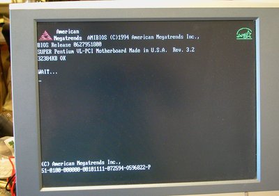

I found the system with this board in it, stuffed into the back corner of a closet, where I put it many years ago and then forgot about it. It was my first hard disk recording system. What a monster. VLB scsi and video, full-size SCSI drive that sounds like a jet engine warming up when powered on... no wonder I upgraded to a socket 7 setup. But it worked fine when retired (in 2001?) and i kept it for backup, just in case.
Yesterday I checked all connections, replaced the dead batteries, shorted the CMOS, and powered it up. Nada. No beeps. Nothing. Double-checked jumpers, all OK. Power supply checks OK, with this board and another one. CPU and memory works fine in another board. I have the manual, it suggests removing things and listening for beeps to determine the cause. Replaced the VLB video with a known-good ISA one. Disconnected everything down to the basics; video, keyboard, two sticks of known-good FPM simm. Still nothing. No beeps. No display.
It seems unusual to me that a board would go bad just from being stored.
Any ideas? With VLB, PCI, and ISA slots, it would be nice to get this board going again. Any advice would be appreciated.

She's alive!
Problem was none of the above. A pcb trace that runs under the battery had gone open, corroded from old battery juice that I did not do a perfect job of cleaning up back then. It all came back to me. When I bought this board in the late 90's, I saw that the onboard battery had leaked. That's why I had outboarded the battery (the board has provisions for both). I thought I did a good job cleaning it up, but apparently not. Bridging the gap with solder would have been enough, but wirewrap wire point to point is more secure.
Now to see if the rest of the system works.

Reply 11 of 11, by precaud
Just disable all the power savings monitoring stuff in the Bios and its a non-issue.
I prefer Dallas/ODIN RTCs or CR2032s over those timebombs.
How about three AA's in a plastic holder velcroed to the case bottom? That's what I did with this one 😀
The system booted into DOS fine. This Seagate SCSI (ST43400N) is the noisiest HDD I have ever heard. But its plenty fast for this system.
When I ran WFWG it displayed the splash screen and then went blank. This LCD monitor is very different from the CRT that was last used with this system. Exited, did a hard reset, then edited the System.ini video settings to reflect this monitor's capabilities. Started WFWG again and viola there it is. Changed the monitor type to "Fixed Frequency", edited System.ini for all modes @ 60Hz, rebooted, and we have a nice 1024x768 desktop.
