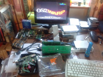

Mister Xiado, tried that, still. Works fine with an ISA drive controller on the same motherboard. I'm limited by PCI slots on the motherboard, I can always scrap the printer port. I have another identical board, but it's already complete in a case running fine. But I'm thinking of putting a socket 5 motherboard with 4 PCI slots, also so that it can better utilise the Voodoo card.
SpectriaForce, have a look at the photo below.
