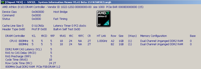

I was rather surprised that your memory is Single Channel Ganged and suspect if you move the DIMM from Memory Bank4/5 A2 to Memory Bank2/3 A1 or similar it will run Dual Channel.
Are single channel and ganged not two different things? While SIV reported single channel ganged, CPU-Z reported dual channel ganged. If I change the BIOS setting from ganged to unganged, then they both report dual channel unganged. I know that the DIMMs are installed in adjacent slots on the motherboard.
Having though about [uefi-info] + [bios-option] I have changed SIV to only call GetFirmwareEnvironmentVariable() starting from Windows XP and released SIV32L 5.41 Beta-18.

  2. Are single channel and ganged not two different things? While SIV reported single channel ganged. If I change the BIOS setting from ganged to unganged, then they both report dual channel unganged. I know that the DIMMs are installed in adjacent slots on the motherboard.
  3. CPU-Z reported dual channel ganged.
  4. I could not manage to find the download for beta-18, only beta-15.
  1. Thank you for the information which confirms what I suspected.
  2. This explains why [uefi-info] was there at all. I suspect when SIV called GetFirmwareEnvironmentVariable() the return status was other than ERROR_INVALID_FUNCTION so SIV deduced the system was UEFI. Later when it called them I suspect kernel32 was confused as your BIOS does not support UEFI and the **** hit the fan. Either way things should be OK with Beta-18.
  3. Looking at Menu->Hardware->Chipset->Chipset MCH then one of the channels is Unused which is why SIV reported single channel, what does SIV report after you changed the BIOS setting?
  4. What does HWiNFO32 report? I am also wondering, does it report the system as UEFI? It may also call GetFirmwareEnvironmentVariable() and trigger issues.

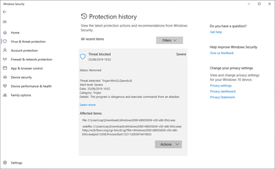

  6. I just tried downloading a Windows 2000 extended kernel and it was reported as a Trojan 🙄 . Given this I am not inclined to install it.

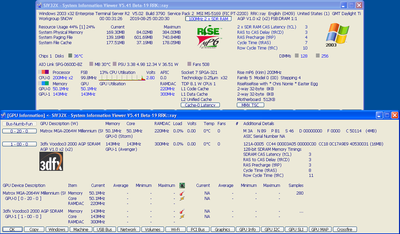

Everything seemed to read fine on this one, including identifying & detecting the clocks on my V3 correctly, although it doesn't seem to get much more else from the card.
Once I release it 5.41 Beta-19 SIV should report the Voodoo memory timings. Are there any things that other utilities report that I could add please?

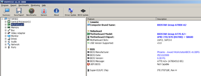

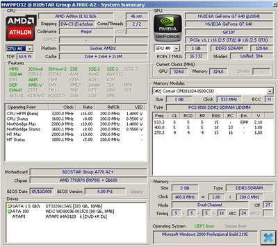

Reply 24 of 1163, by bakemono
Yes, it finishes the whole report without problems.

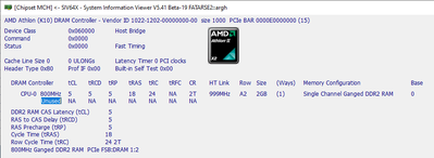

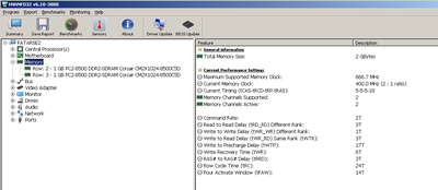

It shows two entries (see pic)

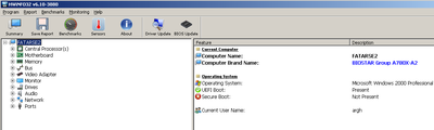

HWiNFO paradoxically shows UEFI boot is true but BIOS is not UEFI capable.

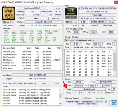

Reply 25 of 1163, by red-ray
Thank you, all is now as I expected/hoped and I am pleased to have got to the bottom of this. Please will you post a new save file so I can see what get's reported now the work arounds work? You should report what I feel is a bug in the W2K Extended Kernel to the guys who provide it and if they contact me I can fill them in on the technical details. I tried to find a contact e-mail address, but there does not seem to be one, do you have one?
How was the BIOS set when you ran HWiNFO? It would be ideal to set Ganged then posted one screen shot showing both what the HWiNFO Summary reports as the Mode + what SIV reports on [Chipset MCH] so I can be sure the BIOS setup was the same for both.
This is what I suspected would happen and prior to Beta-18 what SIV did. I have mentioned this to Martin, don't know if he has adjusted HWiNFO, but v6.11-3895 has just been released which might have been.
I also made the AIDA64 guys aware and the next AIDA64 will use the same work around as SIV uses. I suspect there are several other programs that will use GetFirmwareEnvironmentVariable() and incorrectly report UEFI Boot on your system and if you spot any advise you not to use them 'till they get adjusted or the W2K Extended Kernel get's fixed.

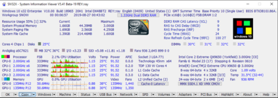

Reply 28 of 1163, by red-ray
DosFreak wrote:
I knw you asked for C2 Extreme but I just finished putting together my C2Q with Windows 98SE so here it is.
Thank you, given this is 98SE I was quite pleased to see that SIV got the cache topology correct and reported both GPUs.
Is the system Dual Boot with Windows XP or later? If so then SIV should report the memory timing information, Disk SMART data, DIMM SPD, etc. if you run it from the other system. Below is what it reports on my Core 2 system.

I am adjusting SIV so from 5.41 Beta-19 it will report one of Dual Channel, Ganged Channel or Single Channel.

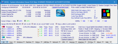

DosFreak wrote:
Same system but with Windows 10.
Thank you, It's good to know the SIV X38 support is OK. I guess you ran SIV from the pre-install environment so the GK110 [GeForce GTX 780] drivers were not installed and SIV only reported the GeForce4 MX 420 [NV17.3] GPU.
Please may I have SIV_Gigabyte_X38-DQ6.dmi? This is a binary dump of the BIOS, contains the raw data reported on the [Machine] panel and when I have it SIV runs better in test mode.

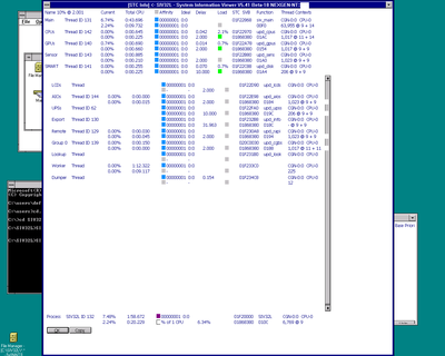

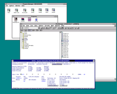

I am now running beta-18 and did not experience any issue with system shutdown. I did still notice that the screen size is too small resulting in your buttons being truncated. Attached are the requested files.

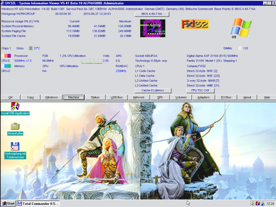

Unoptimized FX!32 execution:
The attachment SIV32L.png is no longer available
Though most of the information is flaky/wrong though.
CPU is a ALPHA 21164A, RAM uses Parity, L3 Cache is 1 MB. GPU is not identified (Permedia2).
It would also be interesting to use the actual native SIV32A instead.

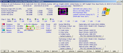

Wow, thank you. I felt asking for SIV to be tested on an Alpha was a long shot, but... I general getting SIV to report Alphas is tricky as much of the information is not available. If you post both the save files I will add support your motherboard and upload a new beta.
Using SIV32L the [Cache Latency] does not work, but with SIV32A it should do as should lots of other things. I suspect on W2K SIV32L would get 21164A, SIV32A should get this on both NT4 and W2K.
Currently I have only tested SIV on my DS20 (W2K RC2) and PWS 600a (W2K RC1 + NT4 SP6).

Thank you for running the test and posting the files. Casting my mind back something changed in the way Windows did screen sizing between 3.51 and 4.00 and this may be the reason for the size issue. Please try the attached SIV32O.exe to see it's any better. It's built to run on NT 3.10 so I suspect it may. You could do Menu->Tools->Maximum Lines->Set nn Lines to tell SIV how many lines to use.
DBGINI 2593  SIV32L V5.41 Beta-18 NEXGEN-NT::feipoa  Built Aug 24 2019 at 16:34:23  Windows NT x32 V3.51 Build 1057 Service Pack 5
DBGINI 2603 Calling net_get_date_info()
DBGINI 2683 Process Type 386 Level 3
DBGINI 2688 Process No CPUID Instruction
Looking in SIV_DBGOUT.log I can see that CPUID is not reported as available. I think this is because IDON.com has not been run, what happens if you run it in a command window?
After pondering IDON I adjusted SIV so please do SIV32O -NEXGEN -DBGINI > SIV_DBGOUT.log | more, the -NEXGEN tells SIV to do what IDON.com does, but I have not been able to test this works. What happens when you try this please?
