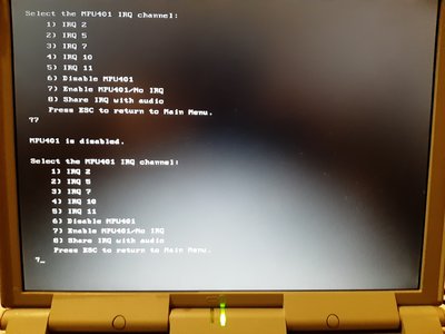

Hello,
I have recently found a a Siemens Nixdorf scenic mobile 710, which appealed me for the presence of a Game port. I would like to use the port for sending and receiving midi to and from external hardware. I have the proper cable adapter, but It seems not working. I have Windows 98se. I tried Fastracker 2, a dos application and fruity loops, windows app.
For testing purposes I tried ESSCFG, a small app to change I/O of audio card, and it says MPU 401 and joystick are disabled, but I can't force it to enable them.
Any ideas? Maybe a proper utility?
Thank you

Reply 10 of 27, by drastikterror
I don't know why, but esscfg.exe tells me mpu-401 is disabled, but under windows 98 midi works.
In my boot manager everything is allright.
I use midiox utility under win98 for testing purposes and I can send midi notes outside...
Just under dos, I get mpu401 disabled

Did you see the screenshot, about esscfg?
I can't enable mpu401 port, it asks me to press "7" but nothing happens...
It remains disabled

Are you 100% sure your version of esscfg fits to your soundcard?
Re: Sound Card Recordings
retro games 100 wrote:
I have tried various things, with the Yamaha DB attached. ... 3) Use esscfg (older version 1.9), and set MPU401 to Enabled ... […]
I guess the version of esscfg matters...

I'm not sure, because I have only windows drivers.
I should try different versions of ESSCFG, do you know any resources?
Reply 17 of 27, by 1541
Windows drivers? But your screenshot shows a DOS tool...
Unfortunately I don't have any sources for different ESSCFG versions.

I was going to tell just this...
In fact on this machine I use win98se, but the drivers provided are for win95. The seem to work well under win, I use midiox to test and I can easily send midi messages to external hardware through midi-game port.
I also tried fruityloops and it worked. Same as Cakewalk.
I'm starting to think that is a Fastracker software issue, probably it does not completely support my card, but audio works well with it...just midi, which is what I would like to use, seems to not respond...
