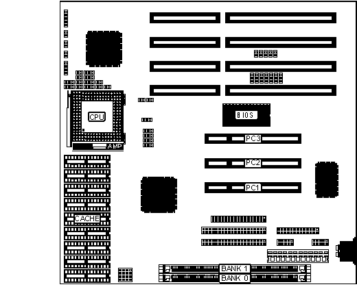

Here's my attempt at making a schematic "à la TH99" like I said earlier 😁.
I didn't label the jumpers, but everything else should be there.

Here's the .pdn file if you want to improve it :

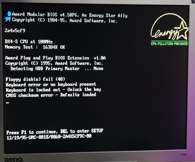

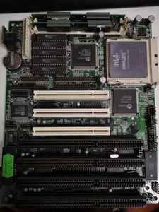

Help me please to find manual, it wont start, only cpu heat, on the back there is text- Liteon 20v0 9608-11

Floppy disk(s) fail is OK if no floppy controller or floppy drive is connected.
CMOS checksum error is normal if the CMOS battery is flat.
Keyboard error or no keyboard present is expected if indeed no keyboard is connected.
"Keyboard is locked out" is not expected when you test a board, and most likely points to a problem. "Keyboard is locked out" means that the keyboard controller (either the one integrated in the UMC UM8886 south bridge, or a dedicated one) has its keylock input line at low level. This line should be pulled up by a resistor on the mainboard, and thus should be at high level unless the keylock switch pulls it to ground. If the board has no external keyboard controller, pin 4 of the keylock/power LED connector should be connected to pin 55 of the UM8886 chip. There might be a "factory reserved" jumper in the path, though. If that jumper is missing, it might explain the error message.
See Success: Adding a PS/2 mouse port to the Shuttle HOT433 (using a dedicated keyboard controller chip) for a detailed description of the keyboard interface in the UM8886 south bridge. The board I modified in that post has a zero-ohm resistor in position R30 to connect the keylock pin (with its pull-up resistor) to pin 55 of the south bridge. It is possible that your board does not use a soldered zero-ohm resistor for that purpose, but instead has a jumper.
