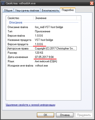

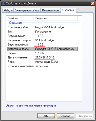

Reply 8 of 299, by evgs
https://kode54.net/vstmididrv.exe
Link is dead...
I am confused.
1.0.0.6 is bigger and more fresh than 1.0.0.8
Can you share lastest version of vstmididrv.exe, please?
