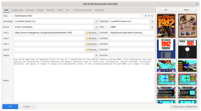

Reply 1448 of 2213, by _Rob
Hi, running DBGL v0.91 on Fedora 31.
When downloading cover art from mobygames, a lot, but not all, of the images are corrupted. I have not used the cover art downloader in months, so I don't know what broke it. But the cover art that I downloaded in the past is fine. I tried it with 2 different games, and the effect was the same.
Just to clarify the images in the preview pane are fine. It is only after you finish and close the edit window that you see the corrupted images. And open the captures folder and opening the images with the system image viewer shows the same corrupted images. So somewhere between the preview selection and storing them in the captures folder they are getting corrupted.

Reply 1453 of 2213, by rcblanke
Thanks for the heads up _Rob, the "Start manually with"-issue will be fixed soon, silly bug.
I'm having trouble reproducing the problem about the corrupt MobyGames images though, can you give me one example game which suffers from this issue?

rcblanke wrote on 2020-03-04, 11:07:
Thanks rcblanke. As to the corrupted images, it happens with any large image it seems. In particular the box shots seem pretty much guaranteed to trigger it. Are you converting the images between the selection and copying them to the screenshots directory? If so how?
As to examples, you can take literally anything. But if you need examples, take "Battlehawks 1942". Here the box shots will get corrupted but the screenshots will not. For some games even the screenshots will get corrupted. I think it depends on size or resolution of the source images.
The attachment Screenshot from 2020-03-04 14-06-05.png is no longer available
The attachment Screenshot from 2020-03-04 14-05-39.png is no longer available
The attachment Screenshot from 2020-03-04 14-09-14.png is no longer available
Reply 1455 of 2213, by _Rob
Forgot to add, I tried with both Java 8 and Java 11.
Reply 1456 of 2213, by rcblanke
Hi all,
A few corrections in this new build:
  • Fixed "Start profile manually with a specific DOSBox version" creating an incomplete .conf file (_Rob);
  • Fixed downloaded websearchengine images sometimes being saved in invalid format (_Rob);
  • Linux: Fixed screenshot context menu items not responding.
All the latest files To upgrade from 0.9x, just fetch dbgl.jar as usual.
Ronald
Reply 1457 of 2213, by _Rob
Thanks rcblanke!
I just applied the fix and both issues are fixed!
