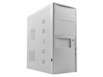

I have entertained the idea but it is very difficult to get a sturdy coat of paint on a PC housing unless you take it to something like an auto repair shop and then the price does not end up being cheaper than a cheap AT case.
I do occasionally come across NOS beige ATX cases from the early 2000s, when I do I grab one or two. I grabbed this for just $15 with a cheapo 300W PSU a few months back, for example:
