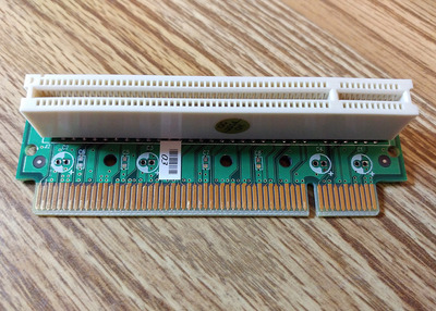

So it looks like I have to add some capacitors to the PCI riser in my Fujitsu S300 to get a sound card to work. (Technically it works already - the driver initializes , there's just no output.) I did expect this, but was hoping it wouldn't be needed.
Problem is, I have no idea what values these caps should have & I'm not sure how to determine it. I haven't been able to find a picture of the riser with the caps populated - AFAIK it was never sold this way. (Makes me wonder why they bothered including the riser at all??)
Here's the riser in question:
278.78 KiB
355 views
Incidentally the part # on it is 736TR3230K100 Rev. 1.0, if it helps (it probably doesn't.) There are four through-hole caps and four SMD ones.
Question: do those surface mount caps absolutely need to be there? If they're all just bus filters, could it work "well enough" without them? I really suck at soldering those. 🙁

Can you check the Sound Card in another system to make sure it works? Have you checked in the Bios if the Pci bus is set as master? I don't remember if my s400 had this option, but it might and it could fix it.
Also, you may need to disable the on-board audio first. Also, in the Control Panel, have you set the external sound card as the Default one?

I've tried a few different known-good sound cards - Ensoniq AudioPCI/Creative SB128 (CT4810) and C-Media 8738-based. The only options for the PCI slot in the BIOS are IRQ and latency (20-255 (ms?)), both of which I've left set to 'auto'. There's no way to disable the onboard VIA AC'97 audio that I can find.
The Ensoniq/Creative cards (I tried a couple of them) are actually initialized successfully on IRQ10 and the driver even loads the wavetable ROM set, but so sound output can be heard. Some/most games seem to detect the sound card, but a few of them give me odd issues - Prince of Persia for example softlocks when it tries to play the musical cue on starting a new game. I think it's waiting for a response from the FM chip that it never gets. (It runs fine in PC Speaker mode.)
The C-Media drivers don't see that card at all (and I know it's good, I've used it in other machines) and fail to initalize.
