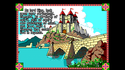

Reply 4 of 67, by KainXVIII
Thanks! Here are zoomed examples for comparing (from Conquest of Camelot), they looks slightly different, i don't even even know which is better 🤣
Sharp
4.04 KiB
No downloads
versus pixellate
4.21 KiB
No downloads
Reply 5 of 67, by Delfino Furioso
it seems to me that the pixellate example shows less color-bleeding
@tyrells - feel free to add my shader ports to your repo I've just forked your repo and created a pull request for including my ports
Reply 6 of 67, by KainXVIII
Uploading fullscreen shots where difference is less noticeable (maybe only in fonts), but yeah less color bleeding with pixellate!
115.4 KiB
