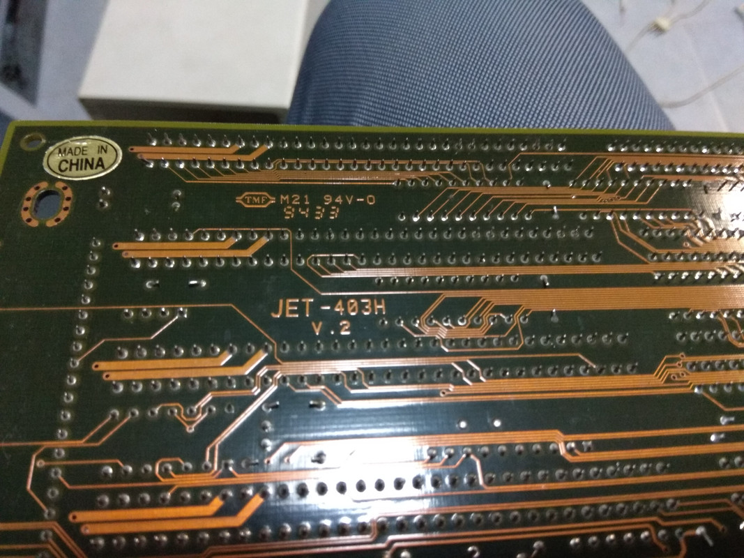

Can you help me identify an old 486 cache motherboard ?
the lettering says: jet-403H m2194V-0 9433 on the back
it's a dx2-66 with both 30pin simms and 72pin simms. full ISA with 3 VLB
lots of jumpers... witch brand is it ??

Decided to fire it up, and see if it posts.. to take note of the bios ID string... and them try to find the manufacter..
BUT,
no post... just the sound of the pc-speaker representing what i bealieve to be reboot's... Damm.. this board as a lot..a mean.. a lot of jumpers... and there's several jumper not represented in the tables drawn in the board itself..

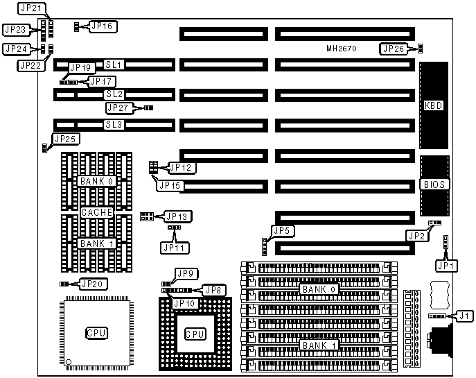

The closest board i cam find is a EDOM 486VL3H (MV020)
it's almost the same layout, just take out the two upper 8 bit isa slots and put two 72 pin simm slots..
1| 386DX40
2| P200mmx, Voodoo 1
3| PIII-450, Voodoo 3 3000
Reply 7 of 11, by Roman555
Yes, yours is very similar to EDOM MV020 and has the same chipset HiNT CS8005.
In 2003 someone tried to find out model but couldn't:
http://www.motherboards.org/forums/viewtopic.php?t=23646

Reply 8 of 11, by dionb
nuno14272 wrote:
The closest board i cam find is a EDOM 486VL3H (MV020) […]
But the jumpers look very different 😢
Reply 9 of 11, by evasive
A JET-403H seems to be very close related to the JET-403 for which jumper settings were already provided.
Jetway boards were sold under the J-Mark brand in the USA.
Reply 11 of 11, by evasive
HiNT: They were pretty decent. Not sure what happened to the company.
There's a page for the JET-403H now: https://www.ultimateretro.net/en/motherboards/10179
If we find any info it will be posted there.
