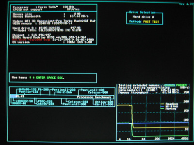

I'm not sure if Feipoa already figured this out, but I remember reading somwhere in the Ultimate 486 (or was it 586) benchmark comparison that Cyrix DX4 486s were getting consistently better per-clock performance than their 8k cache AMD counterparts and he suspected it was due to the write-back cache. (and then falling behind when pitted against the 16k DX4s from Intel and AMD)
However, I'm seeing significantly better memory bandwidth and read/write/move performance across the board (L1, L2, and DRAM) with Cyrix 486s (DX2 and DX4) than AMD or Intel DX2s or an AMD DX4 (or a Pentium Overdrive, but that's at 1x multiplier).
And write-back vs write-thru settings don't change this memory speed advantage, including in the L1 itself. (I've been trying out a Soyo SiS 471 based board that has L1 mode switchable in the BIOS, I haven't used a DOS utility to try changing that on the older OPTi 495SX board)
I've also only done the DX4 comparisons on that Opti board so far since this Soyo board seems to only want to run 1x and 2x multiplier CPUs so far and I haven't found documentation for jumper settings beyond what's printed on the board. (the ZIF socket also isn't really ZIF and seems on the cheap side ... or at least is more finicky about pin condition/straightness than is typical: ie even if the CPU seats fully in the socket, good contact might not be made)
Enabling Write-back mode also didn't help in cachecheck or speedsys scores when the fastest memory settings were enabled but might have a slight impact with slower DRAM timings. However, system stability is definitely better with WT mode enabled and the IBM BL-DX2 seems quite happy at 2x50 MHz here though my VLB cards are finicky. Oddly enough my ATi Graphics Ultra does quite well with the ISA bus set to 25 MHz. The CL-5420 with VRAM does OK with WS enabled at 25 MHz but is only slightly faster than the ATi GU in Doom and Quake but slower in 3DBench and identical in PCPlayer. (and the CL-5422 is a bit more finicky and also more sensitive to which CF card or HDD I use, but I've noticed that ever since I started using CF cards: the CF to IDE adapter I use also seems to matter, so maybe it's a bus noise problem and/or RF noise coming from the card itself ... and the super loud old Quantum 170 MB IDE drive I was using was more dependable for all tests, overclock or otherwise)
I installed a 12 ns tag RAM chip, but the cache still isn't super happy at 50 MHz even at slowest timings in the BIOS but also isn't much or any faster than the DRAM according to speedsys and cachecheck. (at fastest cache timings it's slightly faster than the DRAM, but not by much) With the Pentium Overdrive I didn't have the cache stability issues, but performance was also much lower so it's probably thrashing memory a lot less. (Cyrix at 2x50 was giving 14 us times for read blocks in Cachecheck vs 16 ns for DRAM and 13ns for L1, but the POD at 1x50 did 25 ns for the L2, 30 ns for DRAM, and 20 ns for the L1)
Speedsys score was 40.51
Memory Bandwith = 167.21
8k L1 cache = 87.33 MB.s
memory throughput = 65.66
ANd reading the graph:
Write = 93.75 MB/s
Read = 63.75 MB/s
Move =34 MB/s
(all uncached)

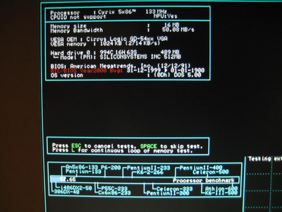

So you want a Cyrix 5x86-133?
I noticed Feipoa mentioned his Cyrix 5x86 tested some years ago wouldn't POST at all when set to 5V and he used 4.0V for some overclocking tests.
He made the assumption that the chips don't want to work at 5V at all, but I think this may be a board (or chipset) specific issue.
They may or may not last very long at 5V, but I did basic POST tests and entered the BIOS with several QFP mounted Cyrix 5x86-100 chips (passive socket adapter PCB mounts, no voltage regulator circuits) and didn't have problems there.
I've avoided actually testing any of those 5x86s further while overvoltated for fear of damaging them, particularly as they might tolerate the overvoltage better than overheating and I noticed a worrying lack of heat coming off the heatspreader surface compared to all ceramic CPUs I tried. (I did short tests without heatsinks, feeling them by finger-touch to the top-middle of the package)
I suspect the poorer thermal conductivity of the plastic encapulation of the PQFP parts ends up insulating the die more and slows the heating of the package. If that's the case, the die itself could be getting far hotter than the surface of the package and would fail to dissipate heat effectively even with a heatsink+fan mounted to it.
It might be OK at 100 or maybe 120 MHz like that, but I'd think going for a higher overclock (150 in that particular board) would be risky. Those same 5x86s did POST at 50 MHz FSB too, which made further tests temping.
I'd think AMD 5x86s (and 350 nm DX4s) would be even worse in this respect in plastic vs ceramic packages. I've done similarly brief (well under 1 minute) POST tests of a couple of ceramic AMD x5 CPUs like that and they get very intensely hot in a very small area (presumably due to the small die size) extremely quickly compared to all the DX, SX, DX2, and DX4 CPUs I've tried like that. So the heat dissipation is extremely concentrated over the die on those 350 nm AMD parts.
They also tended to post at 50 MHz FSB (presumably 200 MHz) but I didn't risk further testing like that.
It's enough to make me wonder if some of the reported failures with overclocking at 5V were more heat related than overvoltage related. 5V is a pretty significant jump beyond the absolute maximum specs of those AMD parts and just generally high for 350 nm silicon, but the thermal issues seem severe enough to be the bigger issue if not really aggressively tempered. (especially given the typical means of heatsink attachment on 486s and especially if tower mounted rather than horizontal with gravity assisted heatsink contact)
If any of the 5V overclocked AM5x86 failures were on QFP parts, that's even less surprising.

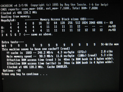

Correction on the Cyrix L1 cache performance, it appears to be somewhat slower than AMD 486s, comparing DX2 chips at the same clock speeds in the OPTi 495SX 3486 board (and older model 5V AM486DX, too).
However the external I/O performance is definitely faster on the Cyrix parts and Speedsys gets easily confused between L1 and L2 cache because of that (at 33 MHz FSB with fastest timings, the Cyrix L1 is only slightly faster than the L2 so it thinks there's only one cache) That I/O (or memory bandwidth) performance still falls away with the L1 disabled, though.
The 'auto configuration' mode also ends up being slower at 2x33 MHz than manually configuring the fastest timing options, but this isn't true at 2x80 or 3x33 MHz so there's some mystery register settings in play.
Quake also ended up faster on the AM486 DX2 than the Cyrix DX2 (I was using my Cx486 DX2/80 with integrated heatsink, but its performance seems identical to the Blue Lightning) and Doom was faster as well.
It may be the L1 cache bandwidth playing a role there since Doom is supposed to like fast on-chip cache a lot and Quake may as well.
The Cyrix DX2 at 80 MHz was getting the same 13 us Cachecheck scores in the L1 range as the AMD DX2 at 66 MHz. OTOH the Cyrix DX2 at 66 MHz was getting L2 and DRAM speeds about the same as the AMD DX2 at 80 MHz. (and the AMD DX2 seems pretty happy at 80 MHz with a heatsink+fan, and is the older 24361 model, definitely 5V and I believe using the same .7 micron process as the AM386 ... )

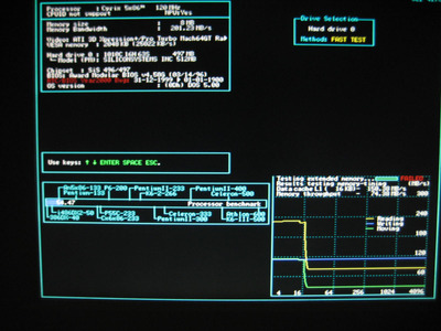

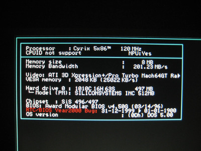

Well, before posting this I just pulled the Acorp board out and tried the DX-50 again and, provided with a 90 mm fan blowing on it (no heatsink at the moment) it seems to go fine at 60 MHz in DOS. (using an ISA IDE card and ISA video card at 1/3 PCI bus speed, so presumably 20 MHz)

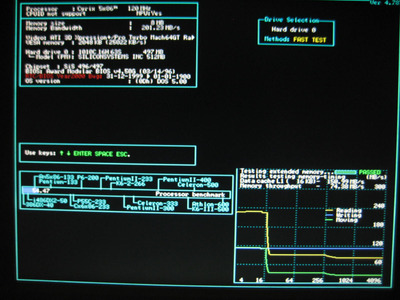

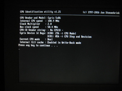

Except doing a bit more testing with a Cyrix 5x86 100 installed revealed more weirdness where CHKCPU was reporting 60 MHz (2x30 MHz) where it should have been 2x50 and another try at 33 MHz FSB gave 33 MHz with 16.7 MHz bus speed. Speedsys scores roughly matched those, too.
So I closed the Turbo jumper and that solved things for the 5x86, which apparently runs at 120 MHz OK at 3.458V. Though I'm not sure what to say about the DX-50 as it was reporting 33, 50, and 60 MHz in CHKCPU. (as internal speed and external bus speed)
The turbo jumper might also be responsible for some unusual performance of other SiS 496/497 boards (including slow memory throughput).
So it's probably always good to try toggling that on a board. (fast mode on my 386SX-40 PCChips M396F also works with turbo closed)

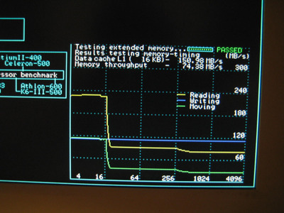

The Cyrix 5x86 100 seems to do fine at 2x60 MHz as well and got some really high scores in cache speed and memory bandwidth (plus 14.8 FPS in Quake timedemo when using a Voodoo3 PCI card, also S3 virge but with corrupted colors due to the 60 MHz bus: my Rage 2+ was fine but a bit slower at 14.1 FPS). I have a Virge DX around somewhere that might be more suitable. (presumably most GPU cores that got used on AGP cards should be fine at 66 MHz PCI ... though I now wonder if ATi's older Mach64 based cards are better on high PCI clocks than some competitors: might make up for the relatively slow performance in some VGA tests)
Oh, in VESA/SVGA modes the Virge 325 (Diamond Stealth 2000) didn't seem to have issues, but in VGA modes it did, both unchained and 13h. Might be the way the palette/CRAM is handled. (PCPlayer 640x480 and Tomb Raider at 640x480 were artifact-free)
PC Player 640x480 got 9.2 FPS with the Voodoo 3.
3DBench got 90.9 in all 3 PCI cards tested.

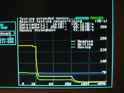

The internal cache of the 5x86 also appears to be nearly 4x as fast as the Cyrix/ST/IBM DX2 and DX4 at the same clock speed. That may be one of the major areas it gets a performance boost even without other enhanced features enabled. The external memory performance is a little faster, but Cyrix 486s already seem to be on the top end of things there.
I'll need faster RAM to get through all the benchmarks at maxed out speed at 60 MHz fsb, but at 50 several 60 ns sticks I have work fine and the L2 cache seems to work at fastest timing settings. (though I'm not seeing a difference in speed between 1 and 2 cycle burst settings)
As it is I can get most benchmarks to complete, including Speedsys at fastest 60 MHz settings, but the extended memory test fails. Still, 201 MB/s bandwidth in Speedsys is pretty fast, or 167 MB/s at 2x50 MHz, where it's stable.
Having the L2 cache enabled in write-through mode maintains the same DRAM speed as with it disabled entirely, but Write-Back mode kills DRAM speed by about 3x. (at 2x50 MHz, Cachecheck was getting 15 us for DRAM block reads with write-thru or cache off and 44us with write-back enabled)

Looking over my photos again, I missed one configuration where the DRAM appears to be in the fastest settings at 60 MHz FSB along with L2 cache enabled, but does pass Speedsys's XMS test.
The DRAM is still set too fast for Speedsys or Cachecheck to specify L2 cache performance, but you can compare the values in the charts and graph at least.

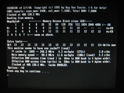

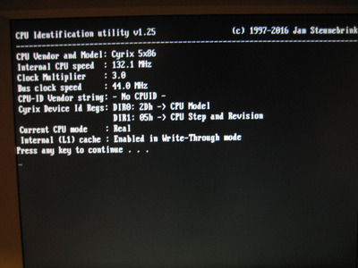

Anyway, have some pics of that ST DX4-100 @ 2x60 MHz and one of the the Cx5x86's cachecheck tests for comparison. (it gets detected as a 486, but it's the one with the 4 us L1 cache scores)
