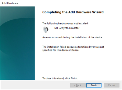

sergm wrote on 2020-06-03, 21:04:
Oh, of course the .INF file from the driver distro isn't meant to work, it is 32-bit only (since it's the platform when it "just works"). I'm hacking on a 64-bit version.
Thanks again .
Now I'm getting this error at the end of the wizard .
81.9 KiB
3285 views
Reply 41 of 82, by sergm
Oops, sorry. An intermediate version sneaked in... Also, it's currently installing just the driver for x64 platform, so not finished, but still this is the "correct way" that makes windows to be mt32emu-aware 😀
Attaching a package that I just tested and it's proven to work.
Reply 42 of 82, by darry
sergm wrote on 2020-06-04, 01:21:
It works perfectly for me too and survives a reboot.
Thank you very much for your work .
