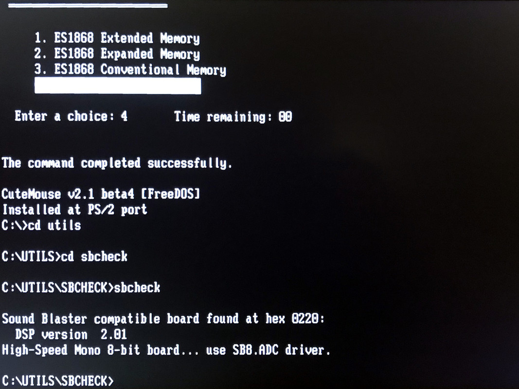

Is the card normally detected? Does it display the DSP version correctly? I will attach several utilities in the archive that can detect and display the DSP version of SB. Perhaps this will help with something, help to understand whether the computer<-> SB card connection is working normally.

So I get a DSP version from SBCHECK. However, I am starting to get the suspicion that one of my BUS logic ICs is faulty as well. I just have no idea which, I may as well order a spare of each and go around replacing them all until I find one..

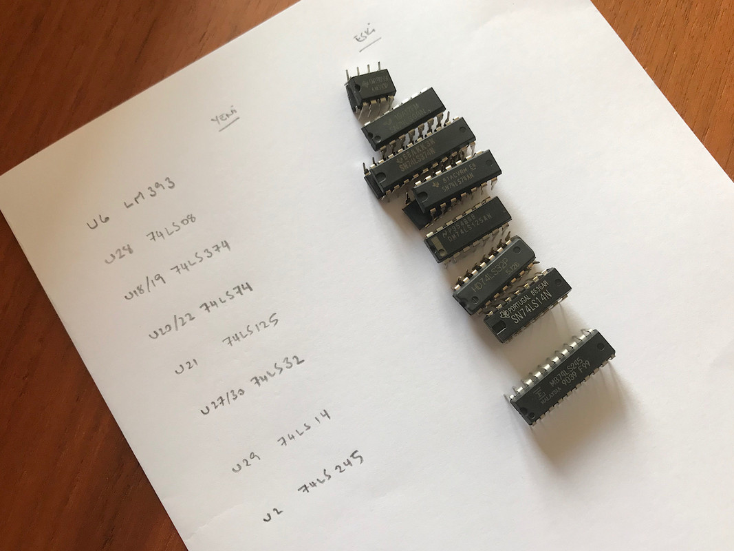

Could definitely be more bad logic chips. I'd check U20, U22, U21, U27, U28, U30, and also the DSP itself. It sounds like digital noise at this point. Where are you getting these logic chips from anyway? You have to be careful--a lot of grey market sources (eBay, etc) sell factory rejects or re-marked parts. Even though they're often cheap, they're more trouble than it's worth.
TubeTimeUS wrote on 2020-07-03, 15:03:Could definitely be more bad logic chips. I'd check U20, U22, U21, U27, U28, U30, and also the DSP itself. It sounds like digital noise at this point. Where are you getting these logic chips from anyway? You have to be careful--a lot of grey market sources (eBay, etc) sell factory rejects or re-marked parts. Even though they're often cheap, they're more trouble than it's worth.
The DSP is from Mouser, via myself. So it should be fine if it wasn’t damaged in transit.
root42 wrote on 2020-07-03, 17:24:TubeTimeUS wrote on 2020-07-03, 15:03:Could definitely be more bad logic chips. I'd check U20, U22, U21, U27, U28, U30, and also the DSP itself. It sounds like digital noise at this point. Where are you getting these logic chips from anyway? You have to be careful--a lot of grey market sources (eBay, etc) sell factory rejects or re-marked parts. Even though they're often cheap, they're more trouble than it's worth.
What @root42 said. I doubt it is the DSP chip, though I guess the uploaded program may have gone corrupt somehow? I don't have the means to program it at the moment but if you guys tell me what kind of programmer I need I can try to reprogram it with the HEX file.
The other components came from a variety of local suppliers. The one in particular that supplied all those other chips has sent me defective ICs in the past, so.. I made an order for replacements, and I will try them in place. It should take a few days to reach me, then we will see. *Fingers crossed*
