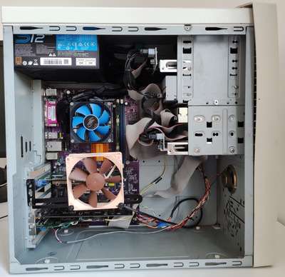

Introduction
This is basically a beefed up version of the computer that I had in the early 2000s. Truthfully, the only remaining original component is the case, everything else has been upgraded over the years. The main purpose of this system is to play A3D 2.0 games and some of the more demanding Glide titles.

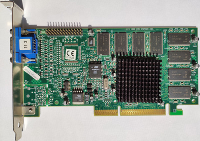

Graphics card
I mainly use the Voodoo 3 to play Glide games of course, but it's also handy for some Direct3D titles which use table fog and paletted textures. Under DOS, the Voodoo 3 offers a crisp 2D image and can even run some (but not all) early DOS Glide games. It also has fully functional drivers for Windows 3.1 for people who want to use that. When playing hi-res 3D DOS games in software mode (e.g. Quake and Tomb Raider) it's best to run FASTVID beforehand to further improve the frame rate. Lastly, the VBEHz tool can be used to force DOS games that use the 640x480 resolution (and higher) to utilize refresh rates greater than 60 Hz on a compatible CRT monitor. My Samsung SyncMaster 795MB can deliver 120Hz at 640x480 and 800x600, which makes games like Transport Tycoon and WarCraft 2 look very crisp.

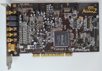

Sound Card #1: Sound Blaster Audigy 2 (SB0240)
The Audigy2 works quite well as a Win9x sound card. It has excellent EAX capabilities, fairly clean output and can use VxD drivers which are more compatible with older titles. It's currently hooked it up to my Cambridge SoundWorks Digital Speakers via SPDIF out, which ensures pristine, noise-free audio reproduction. Should the need arise, I can instead connect this card to a 5.1 speaker system, which is nice for Win9x games which support surround sound (e.g. Unreal Tournament, Thief II and Deus Ex). Under Win98SE, I'm using the Audigy2 ZS drivers as per this guide of mine. Under WinXP, I simply install DanielK's excellent Audigy Support Pack.

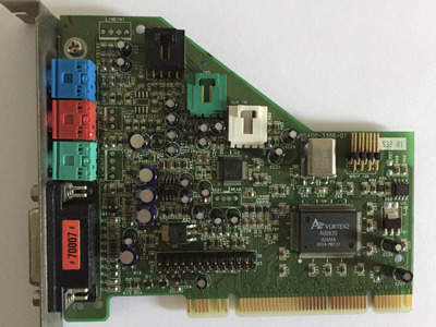

Sound card #2: Turtle Beach Montego II (Aureal Vortex 2)
Of course, the Vortex 2 will be primarily used when playing games which support A3D 2.0. Games based on the Unreal engine (Unreal, Unreal Tournament, Deus Ex etc.) make great use of positional audio on this card, as do other titles like Half-Life and Quake 3. Of particular note is how well A3D 2.0 handles elevation i.e. sounds coming from above and below the player. The manual of this card states that it's better to use headphones than speakers for this purpose, and I wholeheartedly agree. Sound positioning is simply more precise that way. As far as DOS gaming is concerned, the Montego II is relatively solid, and its SBPro compatibility is pretty good for a PCI card. General MIDI sounds ok for the most part, but its FM synth implementation is not really to my liking.

Conclusion
This rig serves its main purpose of playing Glide and A3D 2.0 games quite well. Thanks to modern components like the SSD, the DeepCool CPU fan and the Seasonic PSU, this system is now blissfully quiet as well.

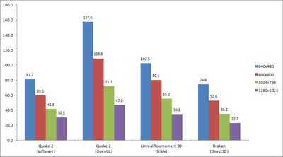

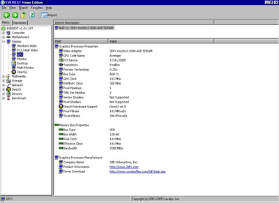

A couple of benchmarks. For the 3DMark entries, the standard benchmarks were utilized, in whatever color depth each one uses by default.
The attachment CPU-Z.jpg is no longer available
The attachment Everest_Graphics_Card.jpg is no longer available
The attachment 3DMark.jpg is no longer available
The attachment Benchmark_Voodoo3.jpg is no longer available
All game benchmarks were carried out using 16-bit color depth. Game versions used:
  • Quake2 v3.20 (with AMD 3DNow! 3.20 patch and 3DFX miniGL v1.49)
  • Unreal Tournament 99 GOTY (Glide renderer)
  • Drakan v445 (Direct3D renderer)
OS and drivers used
  • Windows 98SE retail (no unofficial service packs or third-party patches)
  • DirectX 9.0c
  • VIA 4-in-1 Chipset Driver 4.56
  • 3DFX Voodoo3 1.07 reference driver
