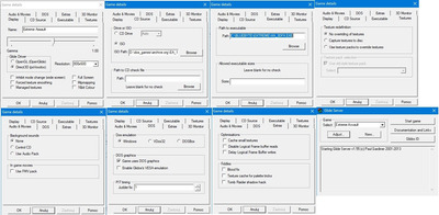

I'm new to glidos and decided to give it a try with extreme assault but I face issue.
I've installed glidos 1.55 to c:\glidos
I've have extreme assault installed to c:\bluebyte\extreme
My config (screenshots below)
Windows 10 (1909, compilation 18363.959)
Glidos 1.55
When I try to run game by clicking on start game button, a console window starts and IMMEDIATELY disappears.
It is hard to see what is going on. From what I can tell, by clicking start game button multiple time
It looks like there is an error like "command.com is not recognized as an internal or external command, operable program or batch file"
I've tried to run glibox from d:\glibox and have game installed on d:\bluebyte\extreme but the problem persists.
What am I doing wrong ?
Also, is there a some kind of log file that could make investigation of this issue easier ? The console window disappears so quickly that is almost impossible to read it. I would be good if the problems like this were logged somewhere..

I've tried to do as you said and the game started, but it was not playable. The first mission was loaded but the screen did not switch to cockpit.
But I was really struggling ito actually run it as 'windows emluation'. Just as the person in this movie did https://www.youtube.com/watch?v=ueeZjuJQE3A .I don;t see any dosbox window opening so I assume it uses 'Windows emluation' option.

Glidos, I undestand what you say, but my point was to actually run the game NOT in 'DosBox' emulation but as 'Window' emulation. A guy that uploaded this movie https://www.youtube.com/watch?v=ueeZjuJQE3A managed to that (presented in first few seconds of the movie) and I wanted to do the same. My question is why the "windows" emulation does not work in glidos for extreme assault and what needs to be done to make this work.
Reply 8 of 12, by kjliew
I guess Windows 10 x64 removing VDM support in command prompt can no longer run any DOS EXE, so you can't use 'Windows' emulation on which GliDOS simply needs to emulate API pass-through into WIN32 DLL. Hence, without Windows VDM on x64 version, you have to use DOSBox emulation.
